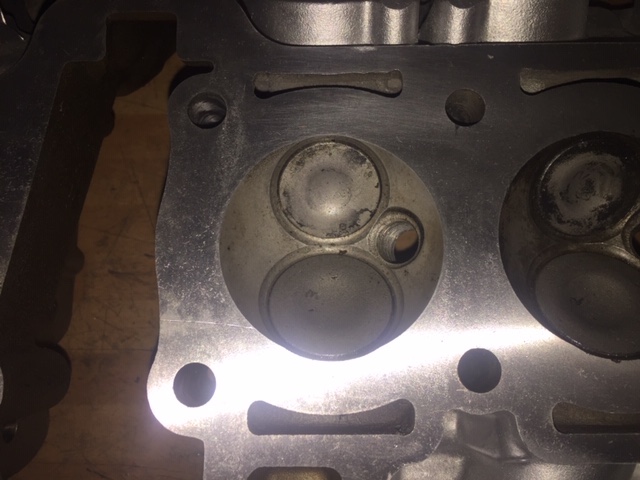

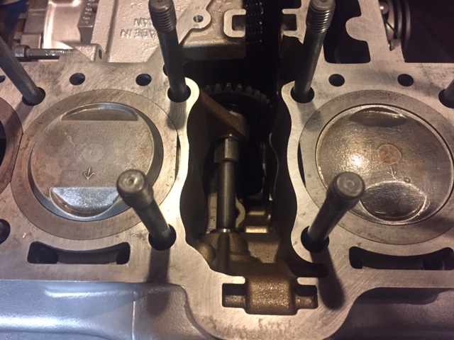

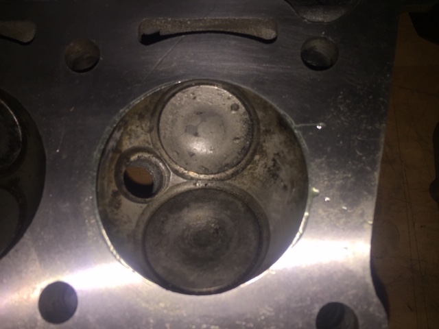

In the meantime I did a little test just to convince myself. I turned the engine until cylinders 3 and 4 were at top position and taped the other rods with tape so as not to damage the liners. Then I attached an original piston and a new one - without the piston rings! - to rods 3 and 4 and slid the tub on using lots of lubricant.
The result is to be seen here:
As you can see there is no discernible difference and the larger cut-outs on top of the new pistons are there to 'accommodate' the valve heads, just like the smaller ones are on the old ones. Then I put some green sticky assembly oil on the tops of the pistons and then slid the cylinder head on. I let it sit for a few seconds and then took it off. The combustion chamber with the original piston had nothing clinging to it, the chamber with the new one had a slight ring of oil around INSIDE the chamber edge where the bevelled edge of the piston was close enough to the head to leave an oil deposit.
Old piston:
New piston:
It is not easy to see (if at all) in the picture, but in addition to the oil on the head 'face' that you can see easily, there was an oil ring INSIDE the combustion chamber, roughly same size as the piston bevelled edge. There was nothing on the valve faces, so obviously they (in closed position) did not touch.
Not sure if the piston bevelled edge was actually touching the inside of the combustion chamber or not and there was no head gasket involved in the set up, so still not entirely sure if it would actually hit or not, but for now I cannot see any exposed liner or the new pistons hitting the valves...
Thoughts?
