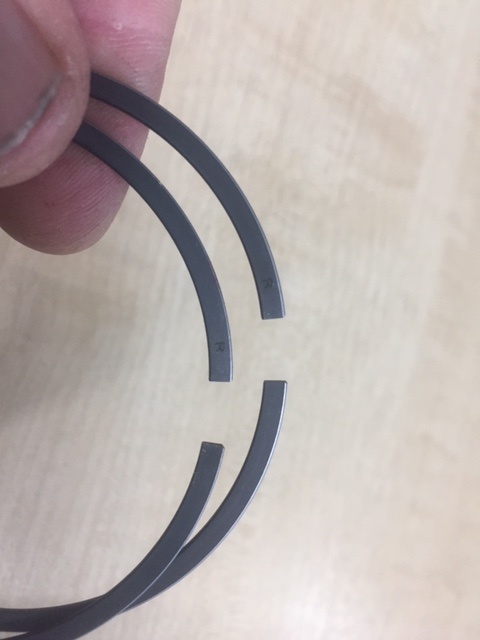

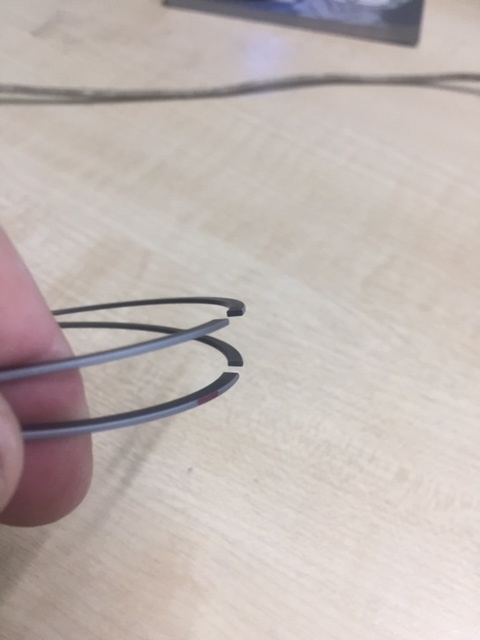

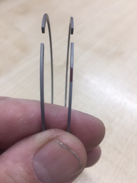

Just checked on the cruizingimage rings again. You already have them, so please confirm. They are described on the packaging as 'Top ring 1R', 'Second ring 2R'.
Yet both rings have the same 'R' stamped on them, and their profiles are identical. They look absolutely identical to me, shape, color, and markings. Except - one in each set has a red dye on it's's side. But that's just a permanent marker or something similar. Nothing about it in the description. I'd imagine the red would be used to make it easier to spot the right one for top and bottom, but there is no difference between these rings!

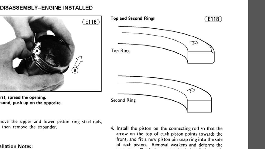

Checking the service manual, top ring should have a different profile - like in the photo below. The cruizingimage rings are simply rectangular. I am wondering if they made a mistake packing those I received or is it how they sell them?... In such case, it wouldn't be good. Rings are specified to go in the right site up, not randomly, and the right profile is there for a reason. I think we are in a pickle with this, and I am not feeling 100% confident with them, unless someone would confirm my observations back up by many miles of happy riding - without excessive oil loss or other side effects!

My Cruzinimage rings are exactly as you describe them, Identical except for the red mark on one of them. I also cannot see a bevelled edge to one of them and both have an R on them. Not sure which is top, but as they are indentical, I guess that doesn't matter (so why one with a red mark???)
Not sure if we should be worried... anyone else have rings that are different (ie; one with a bevelled edge?)

The manual clearly shows the beveled one to be installed on top. Rings can't be installed upside down, or they will start pushing the oil in the wrong direction. Installing without the bevel would in a way be like installing a ring upside down.

Trying to search my memory I don't remember now theory I was taught in this regard. So, just by applying logic, a bevel on the top ring would make the top surface larger, therefore more force would be transferred to it from the combustion gases resulting in the ring expand, push outwards to the cylinder sleeve, and seal it much better. A ring without bevel would be pressed straight down, therefore not sealing as well. So, I think the bevel has to do directly with the combustion gases pressure and sealing the piston at the top. And that is crucial. Also, the chrome aspect would have to do with corrosion of the gases, heat, and perhaps overall more toughness? That's my thoughts.
