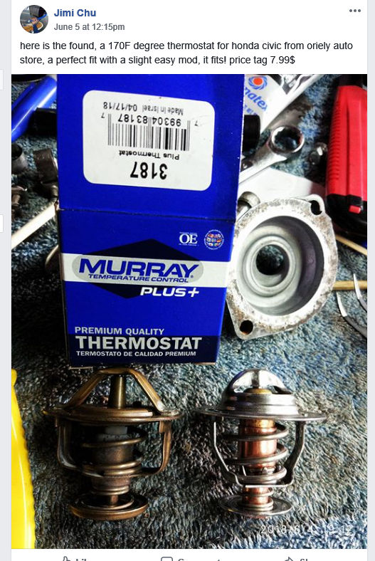

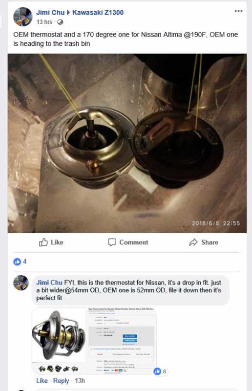

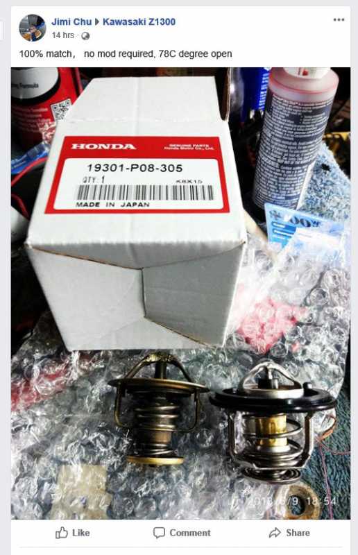

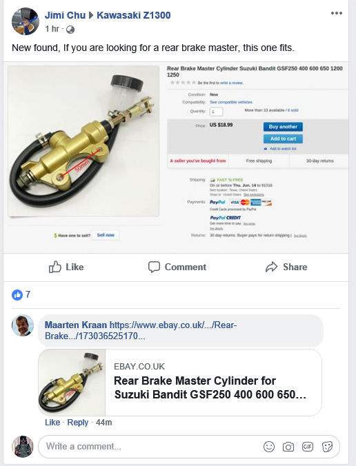

Couple of parts that will fit the 13 according to the author of the posts

Wonder what the "slight easy mod., is ? Thanks for this info !

I've been using a thermostat from a car for years.Don't remember what model. But all i had to do was file down the diameter of the large flat plate portion so that it would fit into the hole. Seems to work fine.
