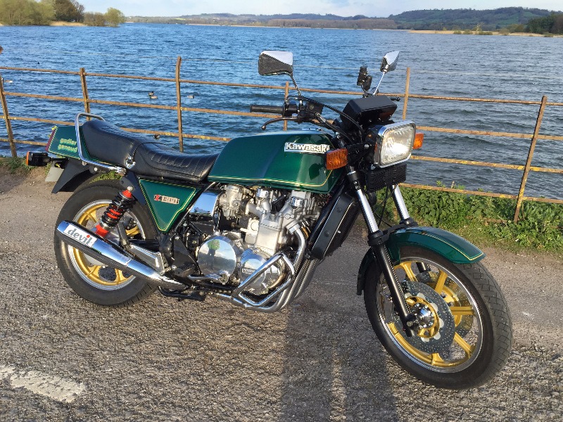

This is my gurl after I repainted her

Looking very nice: it's true the green ones are faster
(but I am biased)

yes, she is a beauty. And of course she is among the fast ones, due to the colour.

Ralpharama Very nice !!! Kudos to you ! I painted mine in darker colors so I can go faster at night ! Unfortunately the shiny bits give me away - so much for stealth !

Nice looking ride there Mister !! Not sure about the green ones being faster. I have only rode red ones my entire life.
