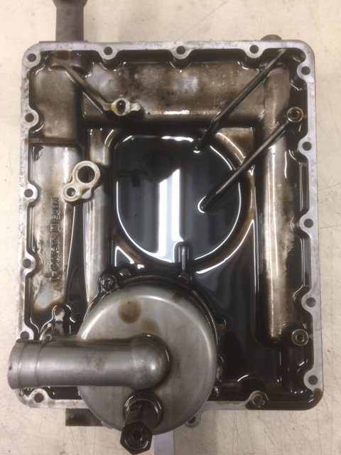

- Posts: 2064
Re: Oil-Pan part 1
9 years 1 month ago - 9 years 1 month ago

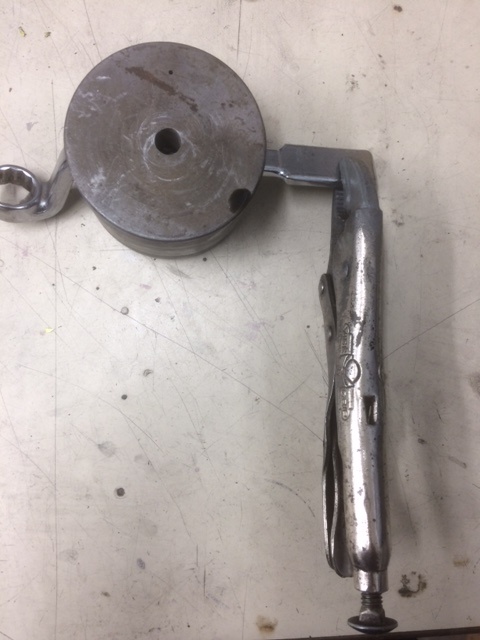

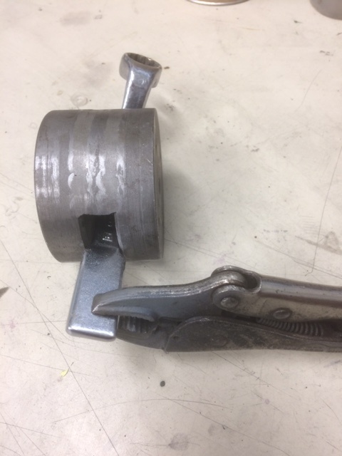

From the time I started to having the oil-pan on the bench took 65 minutes. The header was removed as one piece. Turned the handle-bars to the right and the DG c/w muffler pulled out from the front. I was concerned about the pan being stuck to the block, having read of those who had problems. I took the off-set 17mm wrench from the tool-kit, and made the "assembly" in the photo. A simple slide-hammer" type of tool. Placed the wrench on the front drain-bolt, gave the "slide" 2 light taps downward to the "stop" created by the vice-grips and the pan fell off. The gasket remained intact and stuck to the block.

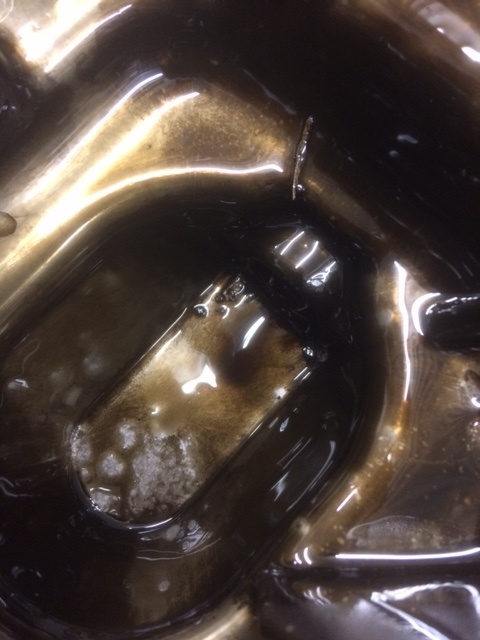

- Posts: 2064
Re: Oil-Pan part 2
9 years 1 month ago
Removed the screen and washed it and the pan. Very clean for 80,000K.

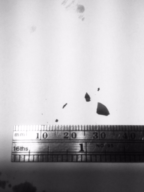

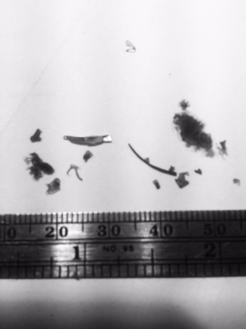

- Posts: 2064
Re: Oil-Pan part 3

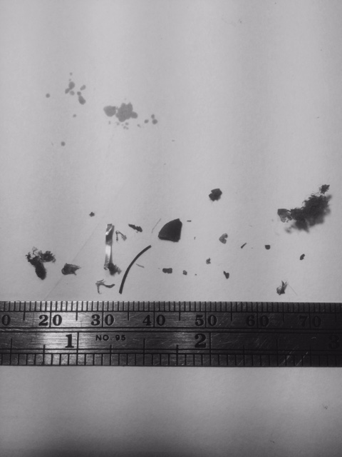

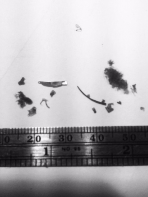

This is what washed out of the screen and into a paint-filter. Several of the tiny pieces were ferrous. The "skinny" length of foreign-material; I think is gasket material. The other
wider long piece is a sliver of brass shim-stock (?). This is the same material I make the Brass Floats out of. It had a curl to it so it is clearly a "trimming" but how it got into the pan is a mystery to me. It was most likely caught in what I thought was a clean rag and perhaps fell into the top of the engine during a valve adjustment/check, at some point in the past. The majority of the material found in the screen appears to be "fuzz" from paper-towels and rags - the same type of material found in my fuel filter (if you remember that article) Go Figure!
I've got 6 new header gaskets ready for the re-assembly but am deciding as to whether I'll bolt the pan back onto the original gasket or buy a new one. I'm in no rush to get it back together if I have to wait for a new gasket but have had good fortune and positive experiences re-using intact gaskets. NOTE: I called the local Kawi. dealer and was told that Kawasaki no longer has them in inventory. Fortunately there are lots of other sources but I find some of the prices plus shipping, quite ridiculous for what you're actually paying for. It would not be difficult to make one so I may opt for that.
I'm going to glass-bead the O/S of the pan to remove the age-stains, will polish the O-ringed elbow, pan-bolts, drain plugs and touch-up the already polished filter-cover and put it back together when I've decided about the gasket. This is an easy one day job and there's nothing to be intimidated about.

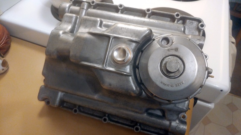

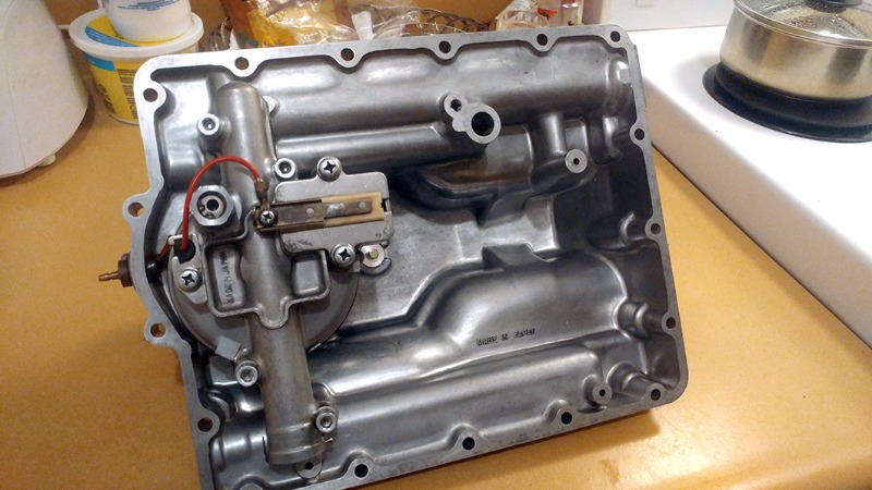

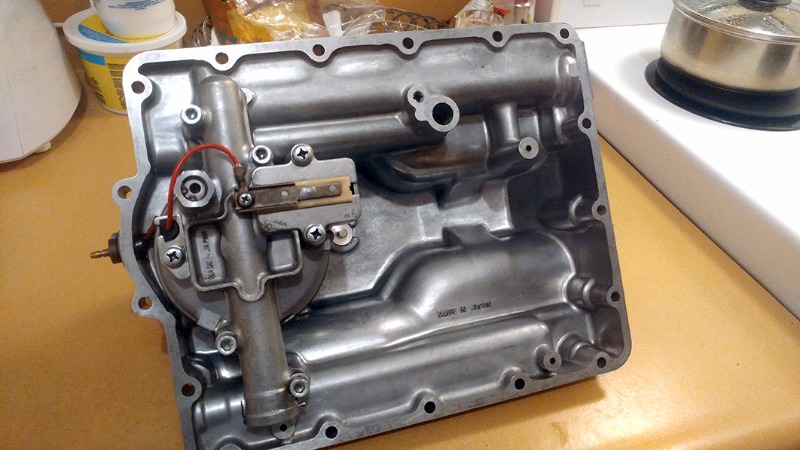

After so many years, I think the oil pan deserved to be acquainted with.
Mine came off after tapping here and there, felt like stuck solid at first. It was quite a bit of constant work but it was off after no more than 30 minutes. I think decades of just standing around made everything less pliable. Good think it got sealed well this way.
Here a couple pick for your reference. As a reminder, it's a 1982 A4. The oil pan now cleaned and ready for a paint coat and then back on the shelf.
If you can spot it, I replaced the OEM oil drain plug with one that has a magnetic element. It's a Subaru - I read somewhere they fit. Perfect. My first performance upgrade, haha
