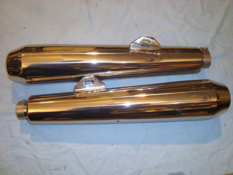

The standard mufflers have been manufactured cheap. The chrome plating is thin and the steel used not very high grade. Trying to remove rust would involve degreasing, soaking in citric acid and rinsing the mufflers many times. Due to the internal construction, the baffles would restrict the movement of the rust sludge, getting them completely clean is not feasible. Stopping the rusting with some media resistant to the high temperatures inside the mufflers can be difficult.
The original mufflers are "consumables" and most chroming companies will not touch old ones since they ruin their expensive baths due to the soot, rust and grease inside.
Ari makes replicas from stainless steel, the inner tube construction is improved preventing the heat expansion ripping effect of the originals. Stainless steel can be polished again and again“, damaged chrome not.
