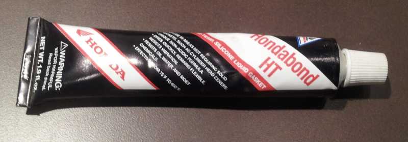

Hi Mike, The grommet you're struggling with is always tough to seal. As you've described getting the oil off of the old grommet and wiring is critical. I've been using Hondabond HT with great results even with an old failed grommet.
Hope this helps.

Thanks Bill, where would we be without Honda,Yamaha,Kawasaki or good old Three Bond! Need to order some on line as I am also building a 72' H2 motor. Used black RTV on the big six's stator grommet after a good de-grease and clean, lasted about a week......back to the drip!
