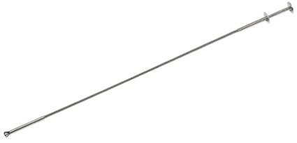

If you can manage to "see" the rubber plug in the lower section of the engine then you could use a 4 fingered retrieval tool like this one to get it out. They're invaluable. They have the ability to pick up /retrieve non magnetic items. The flex neck can be bent to get the tool into unusual places. And best of all, they're cheap. This pic is of one on Amazon.com for $8.50.

10 years 2 months agoKawboy wrote: If you can manage to "see" the rubber plug in the lower section of the engine then you could use a 4 fingered retrieval tool like this one to get it out. They're invaluable. They have the ability to pick up /retrieve non magnetic items. The flex neck can be bent to get the tool into unusual places. And best of all, they're cheap. This pic is of one on Amazon.com for $8.50.
Yes these things are the SHIT!
I was pouring oil into my car and didn't the little piece of foil from the seal pour in with it.... I was able to pick it out with the little grabber. Glad I had one!
