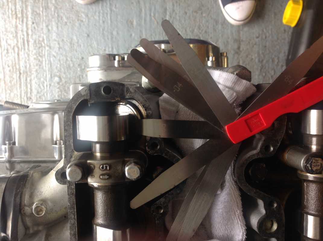

I have got a rebuild thread going on in the new members section. I need some valve shims for my 13. Does anyone have 1X225, 2x230 and 2x245 shims they would like to sell / swap etc please? Cheers Marc. :whistle:
