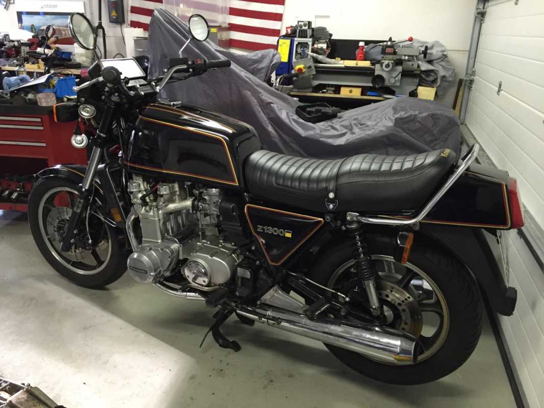

Hi,
I found this thread and was wondering if there are really no differences in the cam shafts of the different models. I just bought a complete head for my Z1300 (European model) with carbs. The Engine has the pick up on the right side of the crank shaft though it should be a 1982 Engine. The old head is done and I got the new one with only 12000mls on it for nothing
Now I have the same questions as the starter of this thread. First thing I see is that the exhaust cam has no! tachometer gear!!(like in the first picture) My old one has one. Second difference is, that the profile of the new cam is much sharper than the old one. It looks like if the old one keeps the valve longer open. The new one is more slim and therfore the valves are not open as long as with the old one. Other than that I don't see any differences. I put the engine together today and will start it with carbs maybe tomorrow. Let's see how it runs
Any ideas how to convert the tachometer to an electronic one (since there is no gear on the cam shaft....)

@ Kwakanuk:
I can tell you, that the engine start perfectly and is running smooth. Since I rarely rode my bike in the past 4 years and can't remember if it was ever better! I feel no difference. The problem is only the rev meter. I'm working on an electronic conversion....
