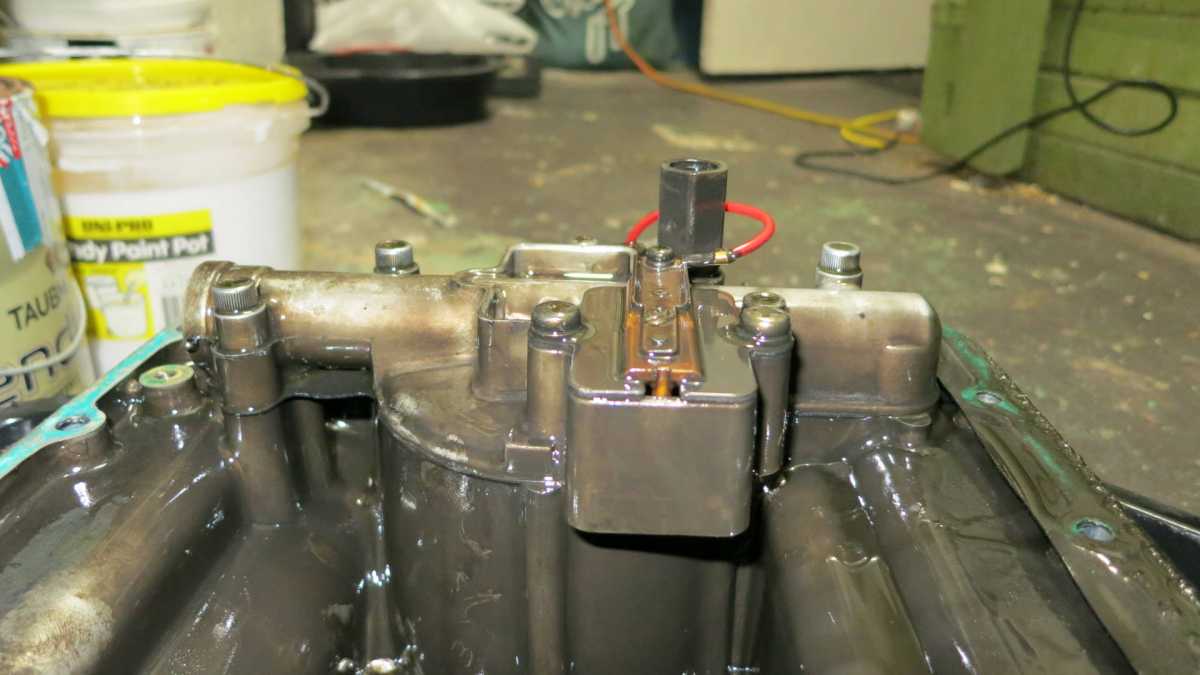

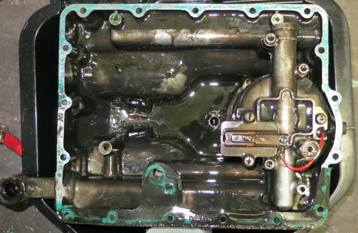

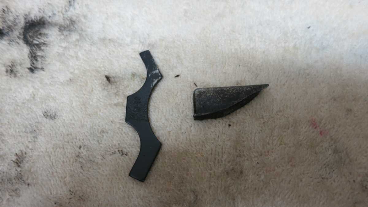

Some photos of the oil pan. The last photo is what fell out of the oil pan when I was positioning it to take the photos :ohmy:
I can see where this piece of shrapnel has come from (right next to the primary chain and just below the timing chain. There was also quite a bit of small pieces of metal in the bottom of the sump (could have come from my starter motor clutch). When I get around to splitting the engine I will diagnose it further. The valve shim tool is in the photo for size reference, it was not in the oil pan
