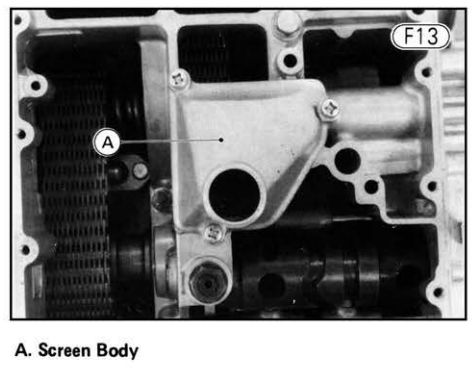

Hey Pete is this what you speak of on page 99 of the service manual?

Yeh undo the screws and the screen is inside between the pickup and the pump body, no biggie but a basic thing that should be checked now and again, sort of the first line of defence to get rid of "chunky bits" from the oil :-)

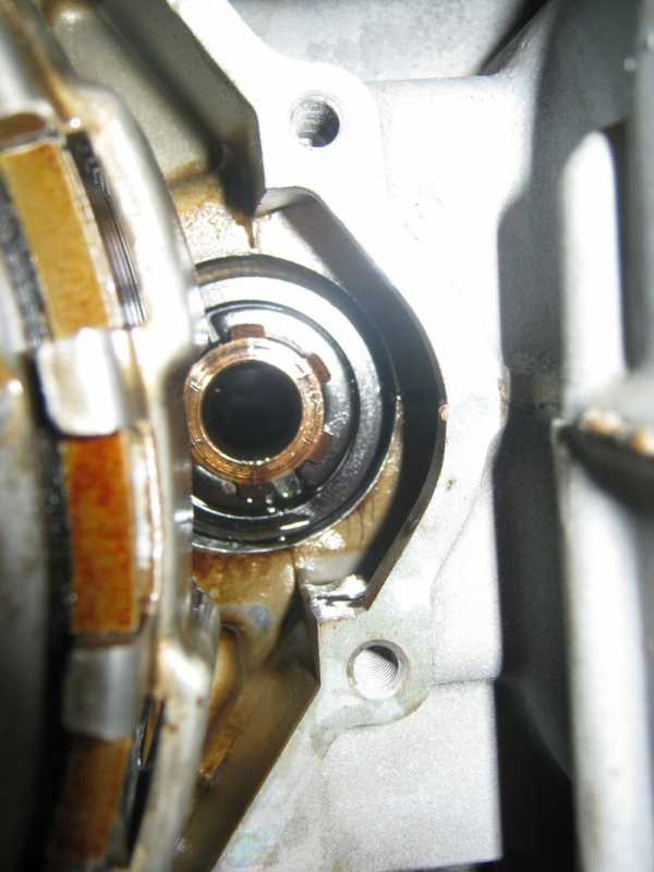

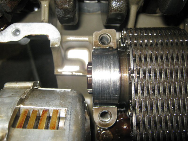

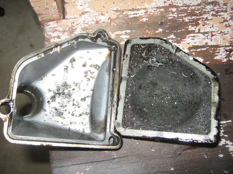

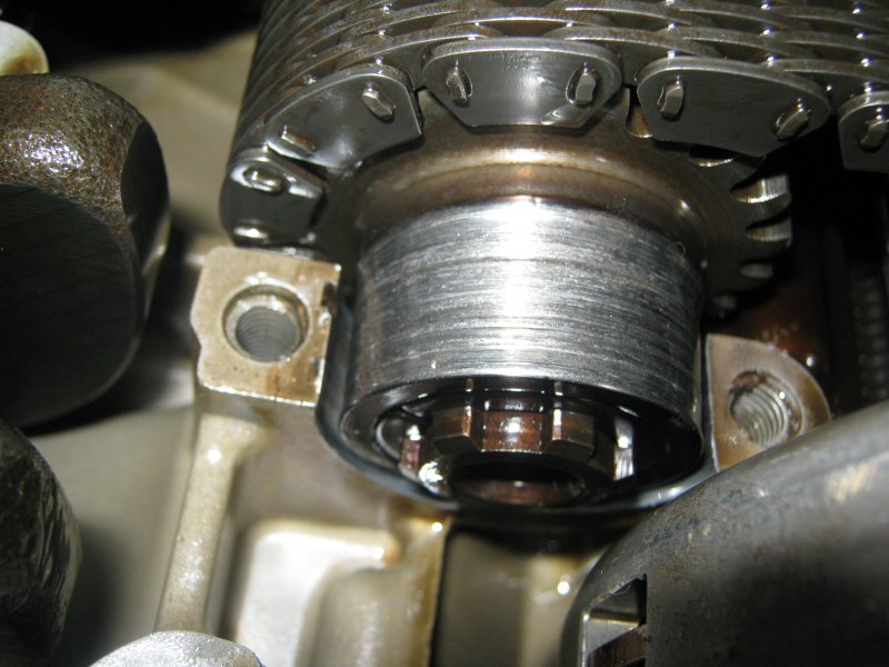

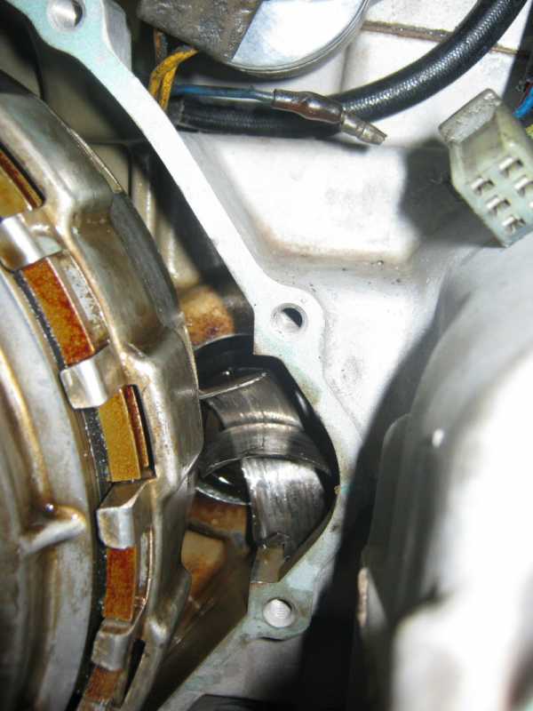

This is my screen after the end of my secondary shaft chewed the case and bearings out, bike still ran, thank goodness those "chunky bits" didn't block the oil passages or destroy the oil pump

That looks like some threads that were stripped out. Serious sort of stuff.

RickG wrote: That looks like some threads that were stripped out. Serious sort of stuff.
Didn't find any stripped threads just a slightly elongated hole where the bearings were, they fell out and the shaft chewed into the case, bike was running but at idle oil pressure light came on, slight "tinkle" noise from around the clutch area, bearings rubbing on clutch basket, didn't think it was bad till I found the other "chunky" bits when I drained the oil, thank goodness for a spare motor, used the cases and the secondary shaft. Live and learn.
