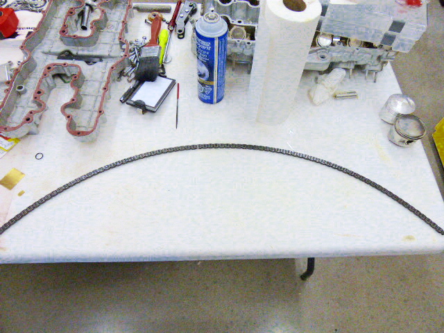

Check the stretch on the chain. Off the top of my head I believe the service limit is 128.9mm over 20 links. It's in the service manual. I've been investigating the specs on the chain because I'm about to replace mine. A new chain measures exactly 5 inches over 20 links since the pitch on the chain is 1/4". 5" is 127mm so Kawasaki is allowing 1.9mm stretch over 20 links. The chain I just pulled out of mine has only 1/3 of the allowable stretch and this photo shows the chain laying on the table and I've twisted it sideways to show the stretch in the chain. I only measured .025" of stretch over the 20 links and I can't accept the chain when it looks like this. I also found a link on the chain which was master link and it looks like it may have been tig welded. Anyway it was tight to swivel and I definitely can't accept that, so I'm in for a new chain. Still trying to spec it out. I only want to do this job once and I'm leery of picking up a chain that was made in China.
Chain standing up and twisted sideways
- Posts: 3298
Re: Won't start. Very low compression.
11 years 3 months ago
Tig welded master link?? Don't know. One pin looks like it was peened properly and the other was ???
