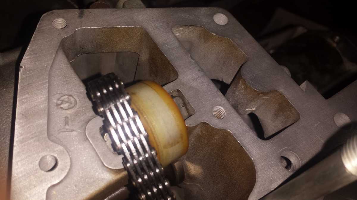

Looks to me like somebody replaced the tensioner and didn't quite fully grasp what we was doing. I'd almost guarentee that isn't stock. Probably a ratchet-type (judging by the small side protrusion and lack of side bolt), mostly likely with the wrong spring.

I took out the bolt in the cam chain tensioner to see what was behind it because I didn't understand how it works or even if that actually was the tensioner. It has a long skinny spring and rod behind it so I guess that makes it automatic? Now to figure out if there is any adjustment left.
Kawboy: So you say that gear should be replaced? I don't know what you mean by multiple teeth on the same tooth? Do you mean the dark marks across it? If the head has to come off is there something else I should be doing while that happens? Performance mod opportunity?

Basically, that gear is pretty ratty. The top edge of the teeth should be smooth, lengthwise. It the teeth are thin enough to get ratty along the top, you really should get it replaced.

11 years 3 months agoKawboy wrote: I'm looking at your 3 pic and I see UGLY. The nylon gear in that pic is part of the cam chain tensioner system and it's not suppose to have multiple teeth on the same tooth. The cam chain has been flopping around and it's cut the teeth. You need a new gear. Bad news is the head has to come off to replace. Good news is the gear is still available from Kawasaki at around $55 Canadian.Some members have opted for the aftermarket LISKA steel gear at around $110 U.S. I hesitate to use it because I'm hearing reports of noisy for the first 200 miles and then they quiet down. That suggests to me that something is wearing in and mating. Would that be the gear wearing in or the cam chain?
The tensioner looks like a modified stock tensioner. Some people have drilled a hole in the back end and tapped then inserted a LONG FULLY THREADED BOLT with a lock nut . Then manually adjust it and LOCK the bolt in its place. Yours looks like it just has a bolt in it, Where's the adjustment? I would suggest you search EBay for "KZ1300 tensioner" and you should find an APE tensioner for around $45 U.S. I prefer the manual one over the modified ZXR 1100 one. (to each his own)

Sorry for the confusion regarding the multiple teeth on the same tooth. The profile of the tooth on the nylon gear should look exactly like the profile on the camshaft tooth only on a smaller diameter. Your teeth on your gear have had their faces shredded and now each tooth has 3 teeth ( hey Scotch, guess I should have been a dentist). Our member Brandonsmash posted a picture of his nylon gear just 4 days ago and it looked like this.
You need to do the gear, nylon or steel replacement, you need to do it and the head is coming off.

I understand what you mean about the gear teeth. What would have caused my gear to wear out like this? Bad adjustment or just age? Cam chain stretch? All of the above? Do I need to replace the cam chain as well?
