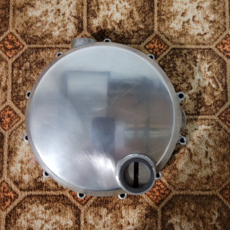

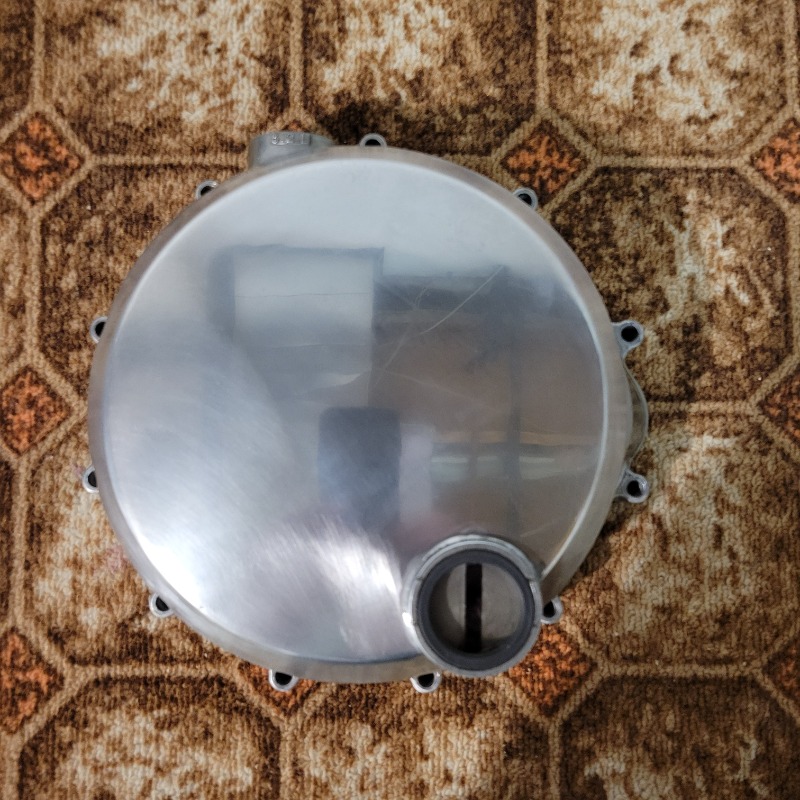

Started cleaning up the engine side covers that I had put on to "mask off" the engine for painting. The VHT caliper paint wiped off with a bit of Lacquer Thinner which is troubling. I had hoped that it would have been tougher but its not. Anyway, the clutch cover cleaned up ok but I wasn't happy with it. The aluminum was dull so I figured I needed to get at it with the wet and dry sandpaper before clear coating.
OMG !! It had clearcoat on it that was tougher than bullets. 6 hours with 320 wet and dry and I still have the side of the cover to clean up. I don't know what they put on it at the factory but if I had to guess, It's some kind of epoxy. Reminds me of 5 minute epoxy like the stuff I used to fabricate the wing (duck tail) on the rear tail piece.
Clutch cover after 6 hours of wet and dry. I also went to 2000 wet and dry to see how well it would clean up.. Still needs more work at 2000 to remove the scratches.
