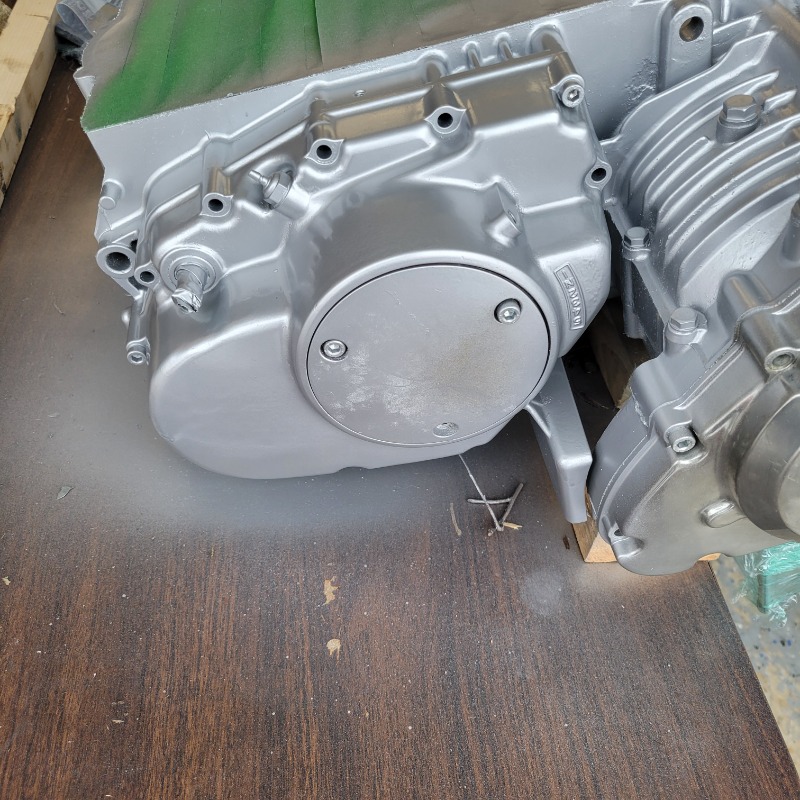

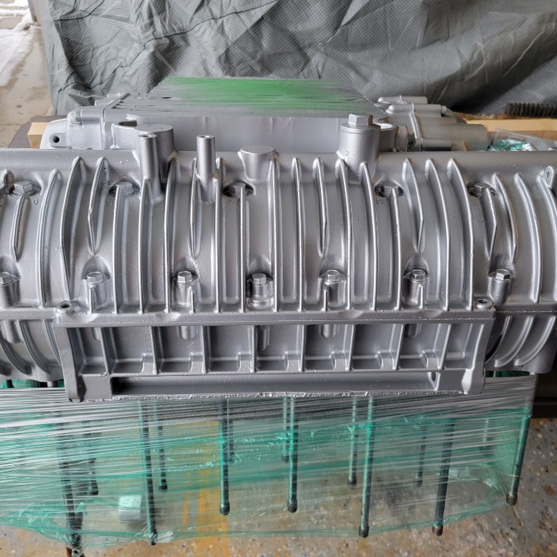

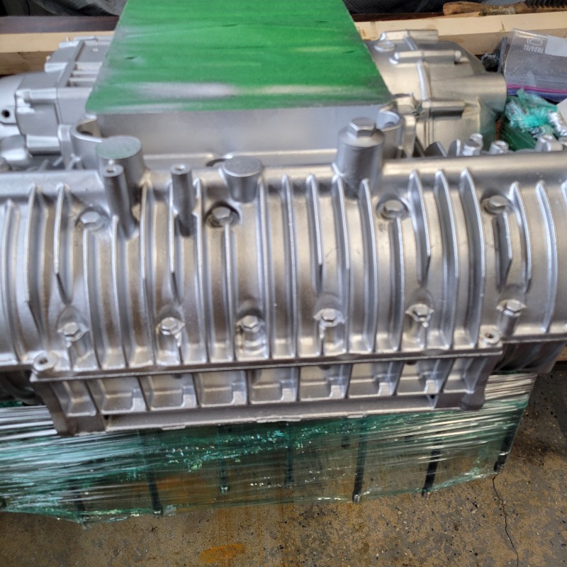

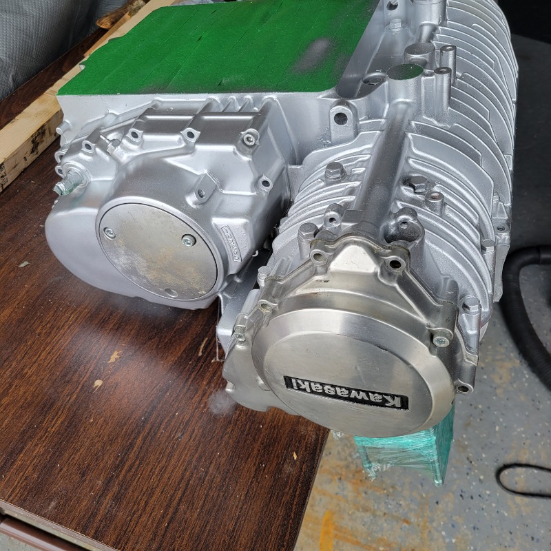

Got a chance to finally spray the Rust-oleum BBQ paint which is a satin finish and has a bright aluminum micro metallic in the paint. I started on the bottom of the engine and sprayed most of the bottom. Once it dried, I decided that I don't like it. It's too bright, so back to the drawing board.
Next up, VHT Brake Caliper paint in the color "Cast Aluminum" This one needs to be bake cured at 200 F for 1 hour after the paint dries and the instructions suggest that the heat of the brake caliper when in use can achieve that. So I sprayed the bottom half of the engine again and I like it much better. It has a satin finish and no metallic. Slightly more to the gray side than the aluminum side.

You may find the newly painted finish too shiny.
Inclement weather and the passage of time cause it to lose shine.
It could be the case that after a summer vacation on the beach you end up with the perfect coat of paint.
