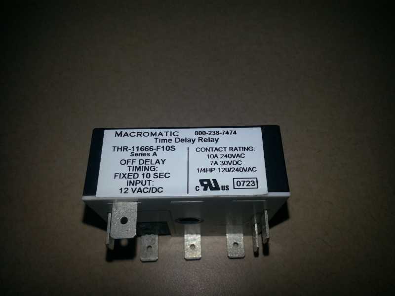

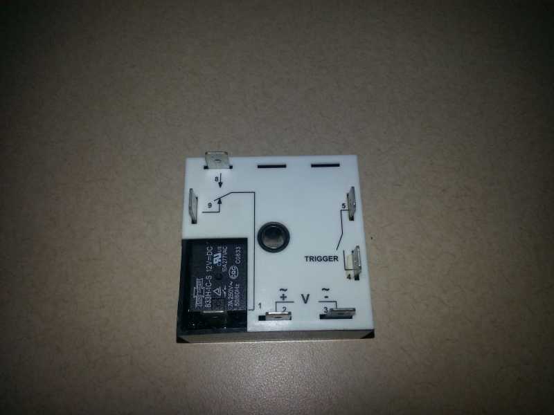

How about a simple Time On Delay relay that can be purchased with set delay, say 10 seconds. It would give you 10 seconds from when you turn the key on until the head light comes on, should be enough time to start the engine. Simple to install, cheap, and would do the job.
I happen to have a 12V 10 sec. module sitting on my desk right now, you can get them with adjustable time delay as well. This one is a time off delay, you would need a time On delay. Cost is like $20 US.
