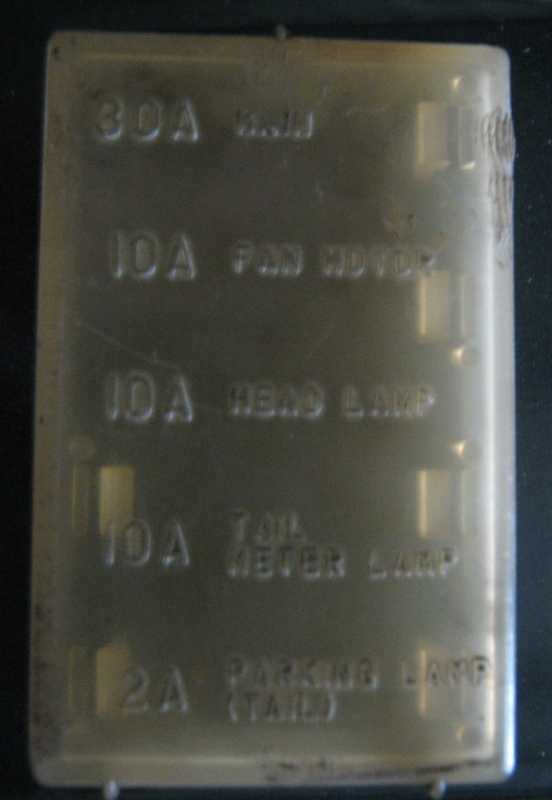

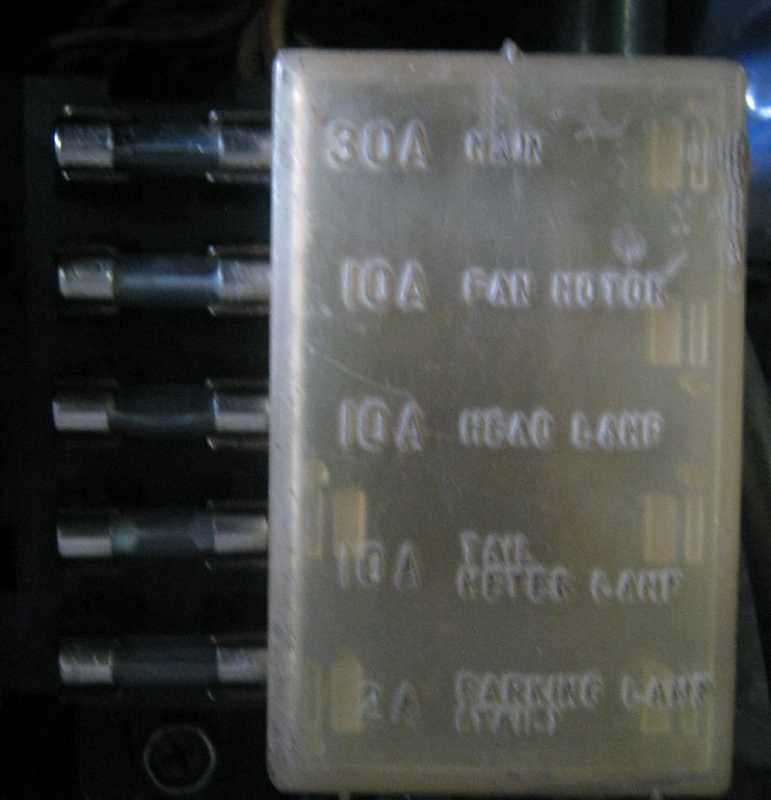

From the Right side to the left side: 30A Main, 10A Fan, 10A Headlight, 10A tail light, 2A Park lights. The correct length can be bought on Ebay. I had no luck finding an automotive supplier that carried the shorter size.

Definitely have to get me one of those.....
Good luck with THAT happening. Will probably end up making something instead...
