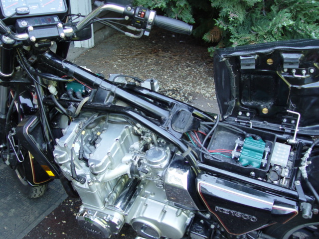

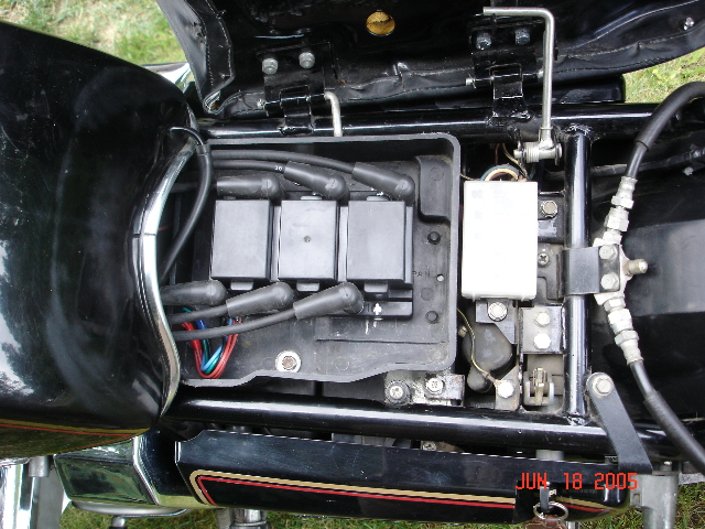

I'm sure you've all read plenty about substituting a GM coil pack for the standard types of coils typically used on motorcycles. Back in 2005 I went so far as to install a coil pack on my 1300. The bike ran fine but I ended up removing it in favor of a trio of Dyna 3 OHM coils because I didn't like the fact that I had to use a ballast resistor to makeup enough resistance to protect the igniter. I felt that I was wasting spark energy that might be needed should operating conditions deteriorate while out on the road, dirty plugs, etc.
I fitted the coil pack in the tool tray. To do so I had to "mold" the seat pan for additional height to clear the plug connectors. You can see the "molded" area in this next pic.
I realize that many 1300's come stock with a ballast resistor.
What are your thoughts about the use of a ballast resistor verses a coil with the appropriate resistance?
