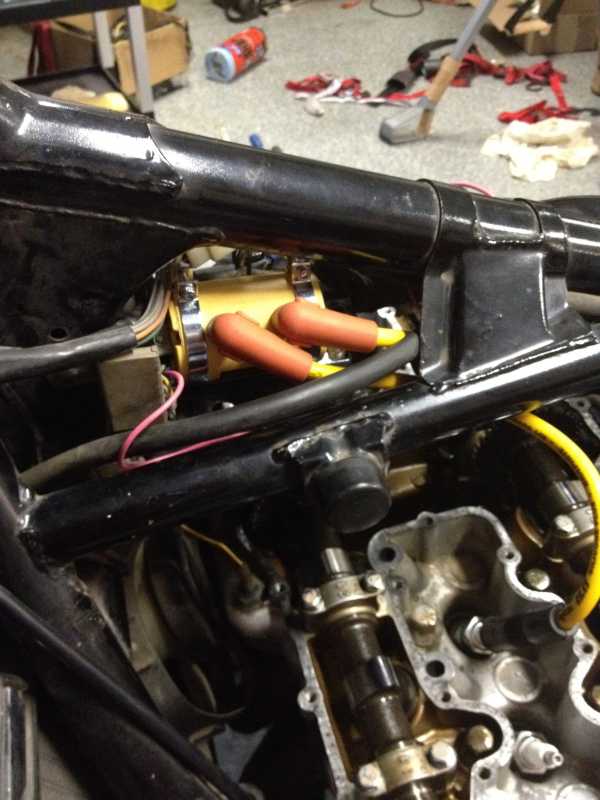

Yes I saw your Post and it's the one I'll probably use but as I was fiddling around with things I determined that with one above the frame rails in the center and two below they can be made to fit quite easily using and modifying slightly the mounting plates that come with the Accel kit. Only issue would be the towers need to point sideways instead of down as they recommend. Was just curious as to whether that would be any issue. Why do they insist the towers be pointed down is my question?? Seems to me they should fire fine whichever direction they're pointing. By the way, thanks for your post, I hadn't thought of cutting the center portion out. Here's how I mounted the top one. The other two will fit under the frame rails in the outer mounting holes BUT the towers must point sideways.

pointing down with the tower is so that if you every burn thru the plug boot your not throwing your spark into the side of the fuel tank. The paper work that came with my set said not to point towers toward fuel tank. Like I said in my post I gapped my plug at .40 not .35 . these coils will throw spark across a .60 gap with no problem.
