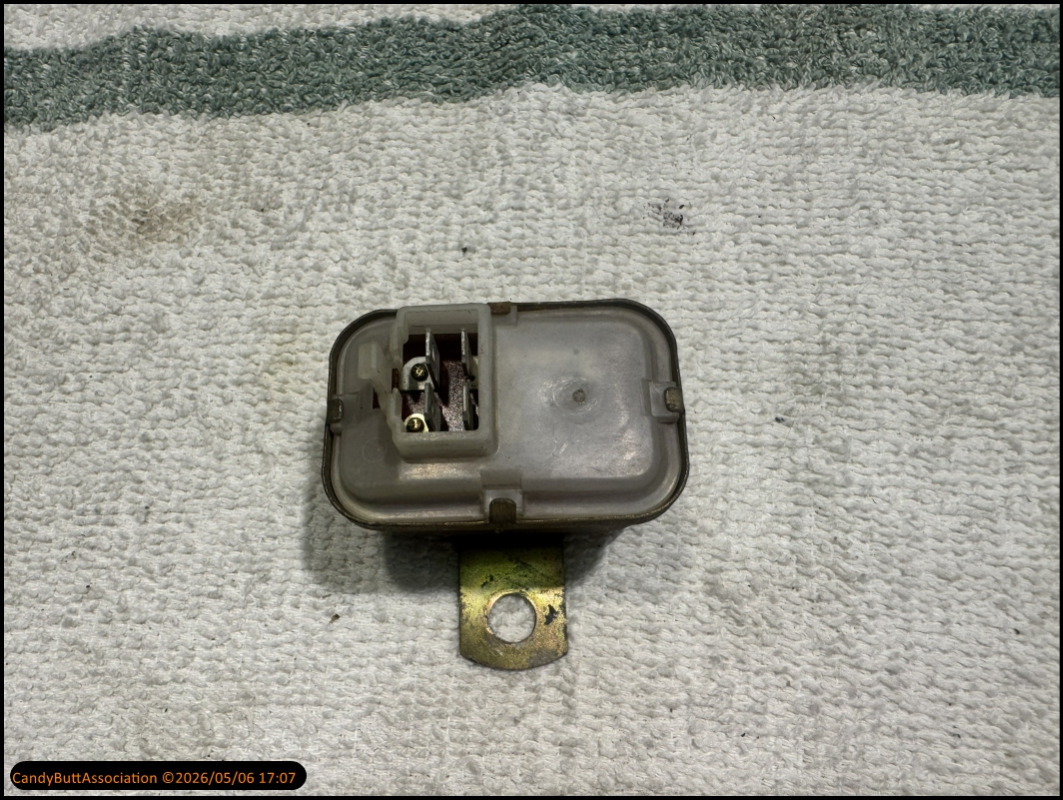

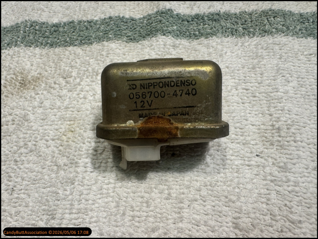

While working on ignition wires , Chocolatie over heated - no fan.
Jumpering the wire at temperature switch to ground failed to spin the fan.

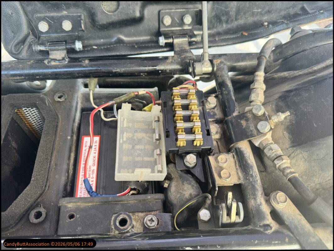

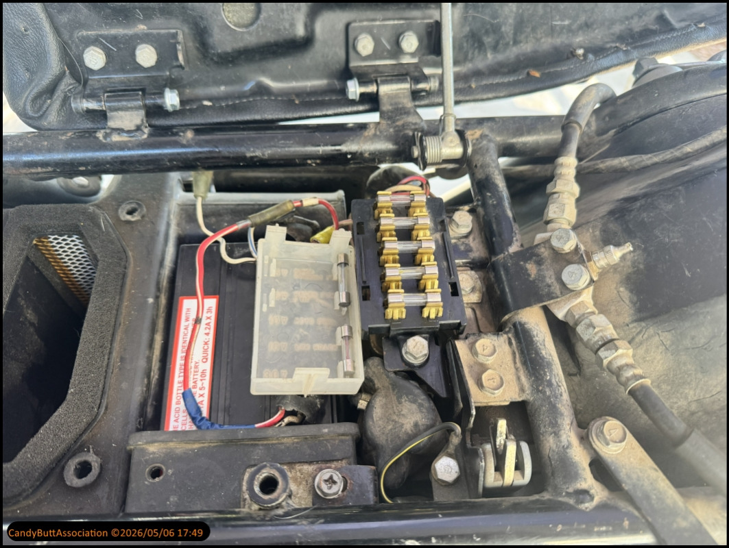

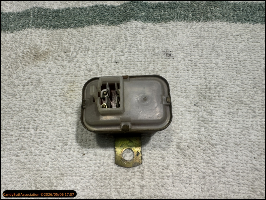

FSM says fan relay is near fuse box. Found it.
Looks pretty good, all things considered.
Going into this project, was confident it would be replaced.
Even went to town and bought a 4 pin modern relay w/ connector.
Researched eBay, found some OEM, but pricy!

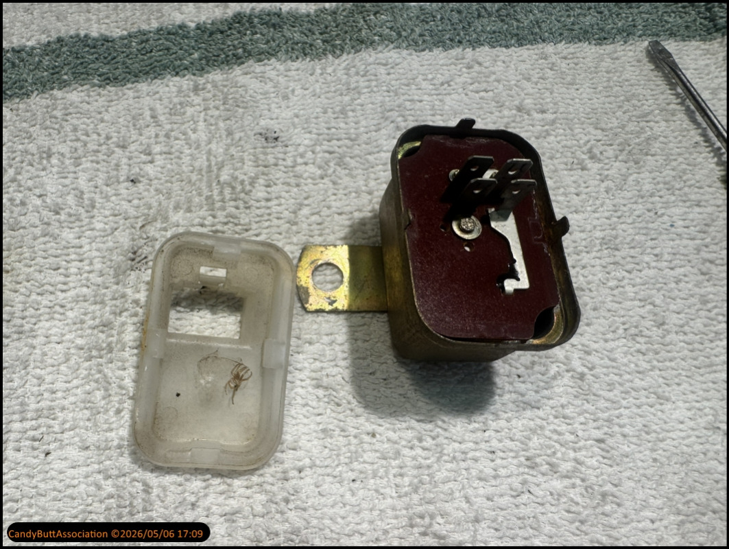

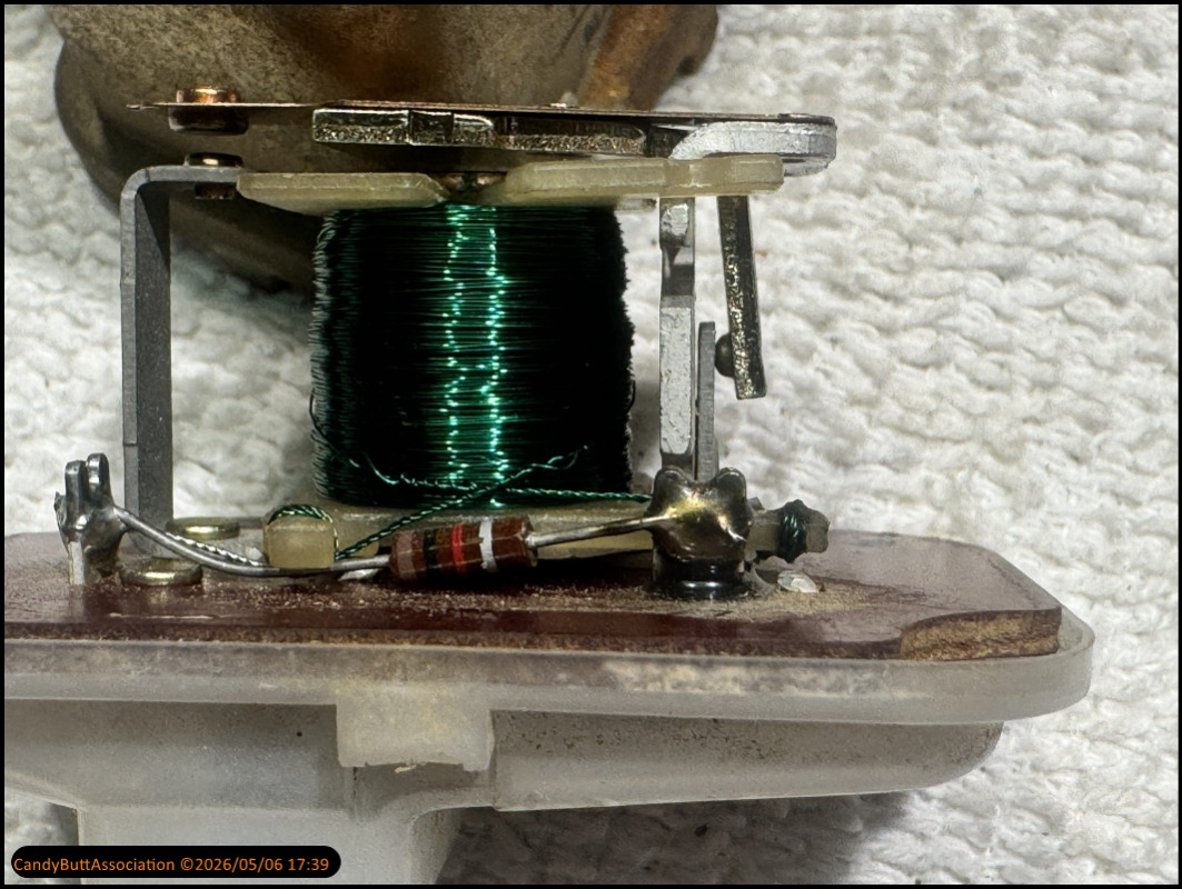

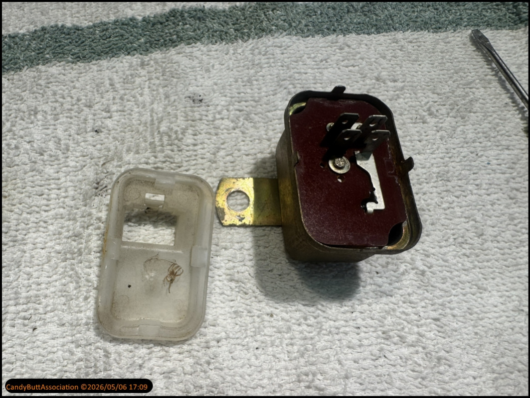

Easy to open. Dead spider.

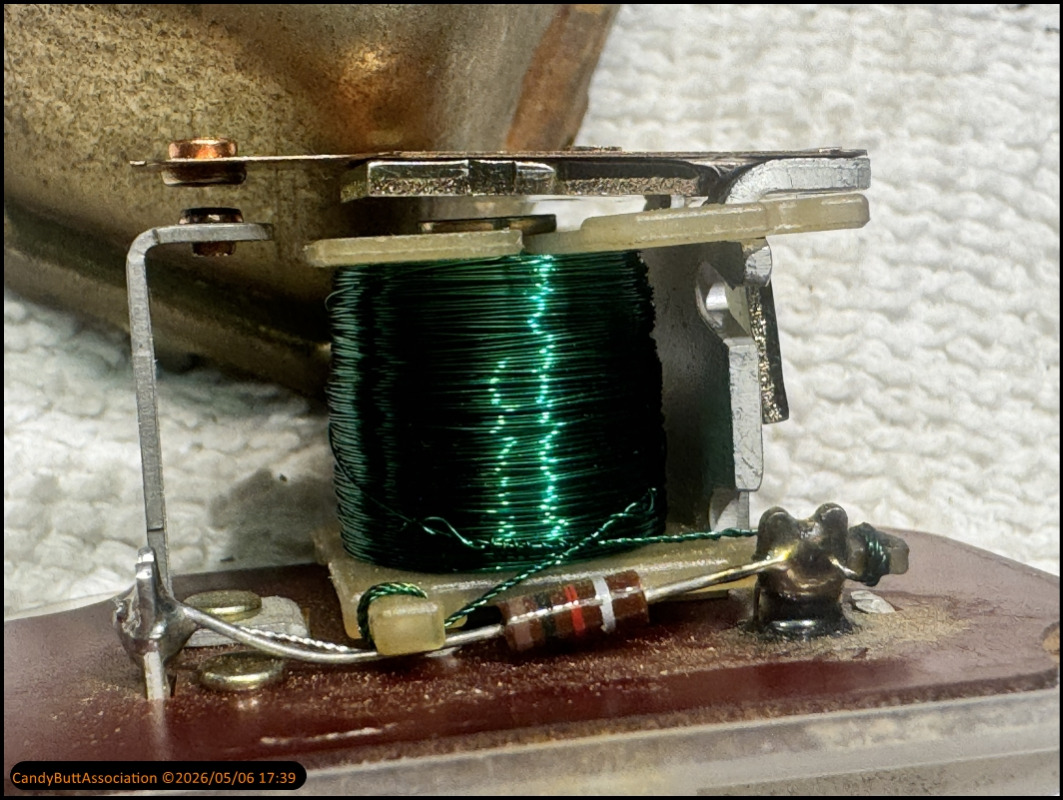

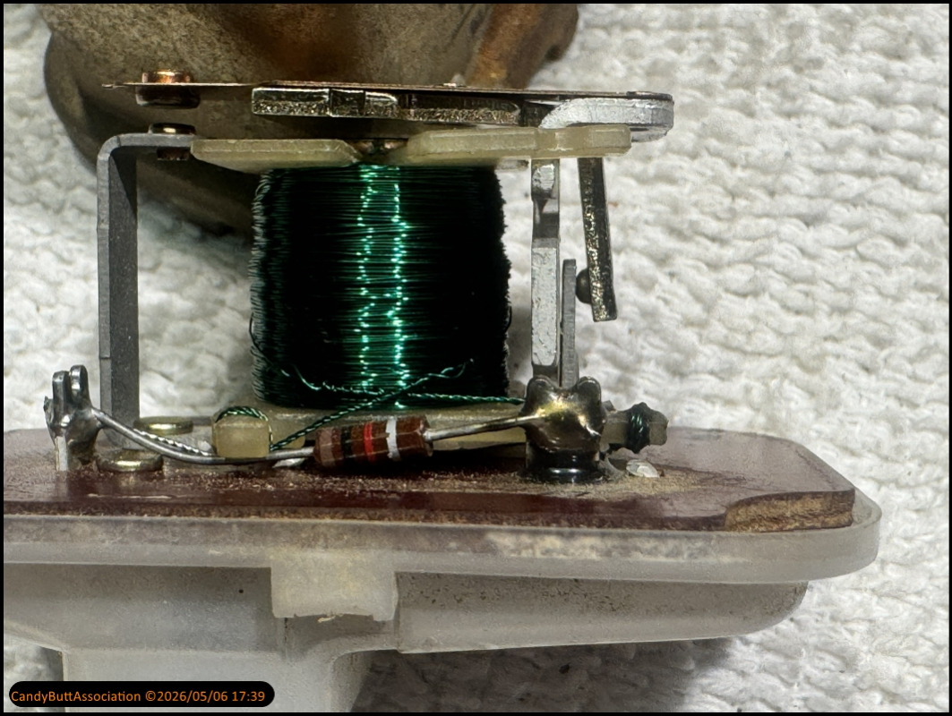

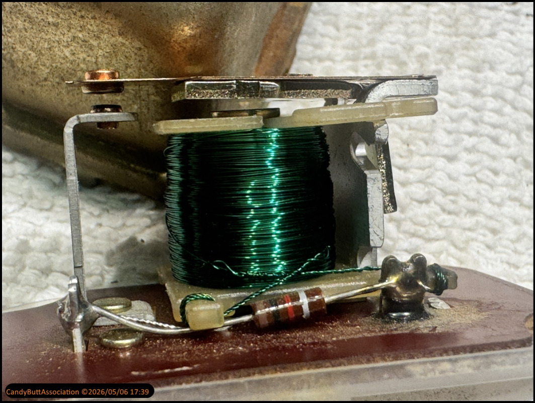

Contacts look good - no pitting. Sprayed them with DeOxit.
It bench tested SAT.
Installed and working.
From testing, the relay contacts into the connector had minor corrosion preventing relay action.The temperature switch needs be tested next - but I'm 99% confident it has failed.
The End
