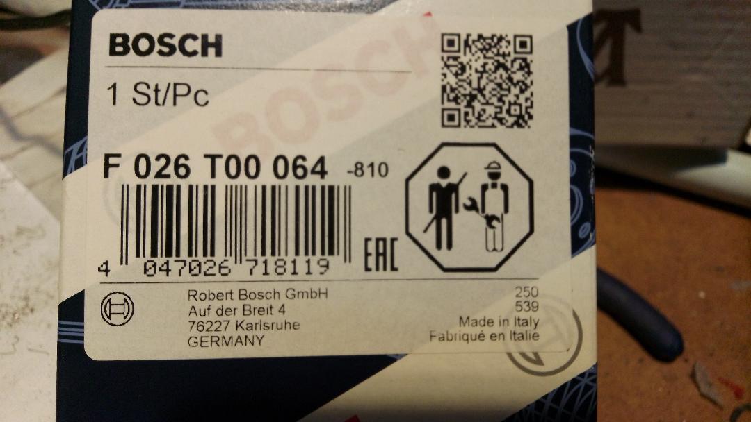

The original 11-pin relay is no longer available, so I found a replacement reference for a Bosch relay.
BOSCH F 026 T00 064 RELAY

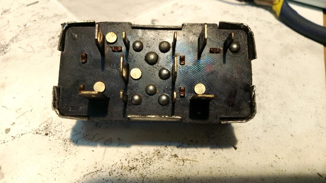

The original relay.

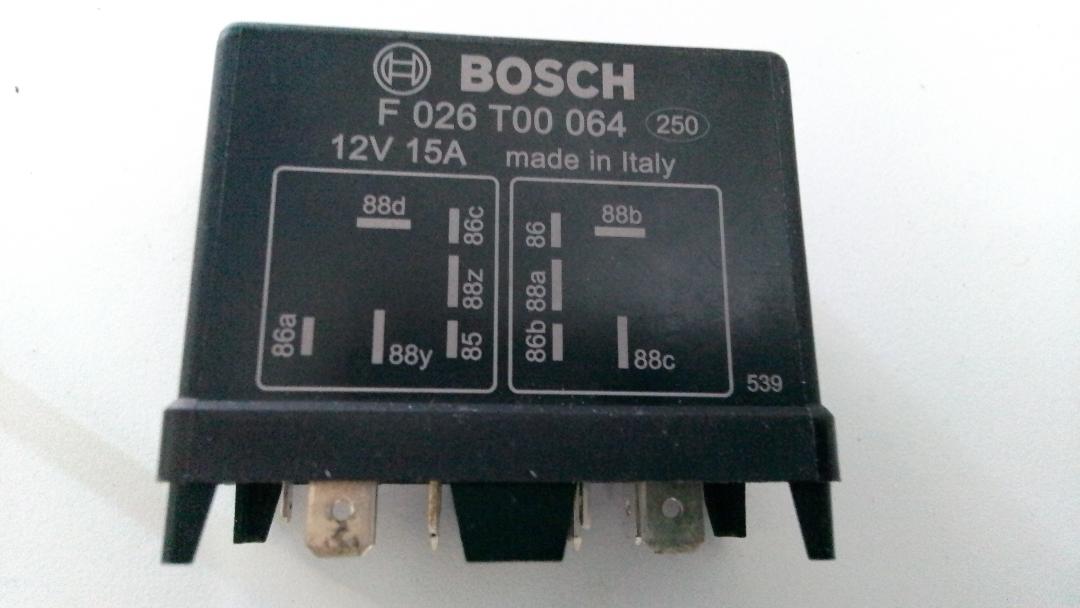

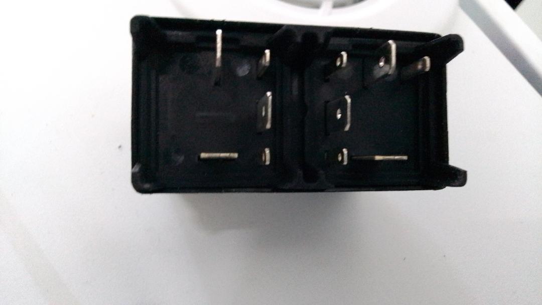

The replace part.

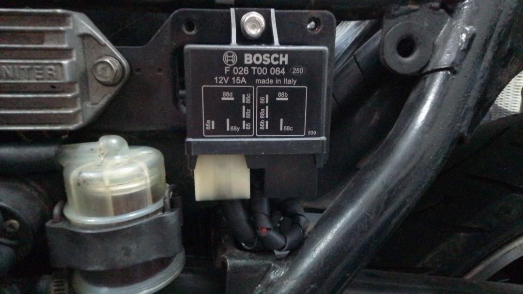

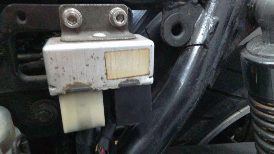

Mounted in the bike.

Nice find. Fortunately, Kawasaki left the Bosch part # on the relay and simplified the search. Still, we appreciate your effort and Thanks for sharing your find.
