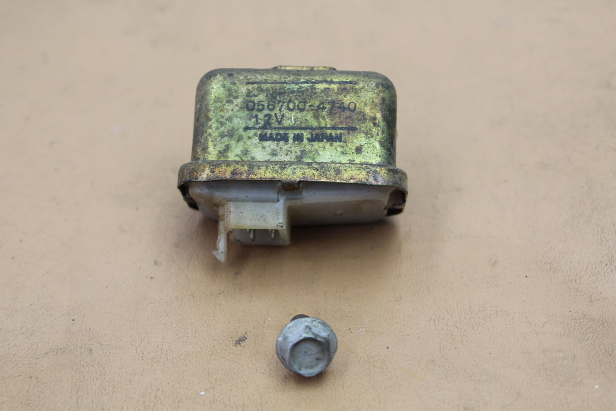

Hi All,
Can someone provide a picture or clear narrative of where the radiator fan motor relay (4 pin connector) is mounted on the bike, please? My bike is a 1980 A2 just in case it's mounted differently on other models.
Thanks in advance,
Andy
Thanks in advance,
Andy

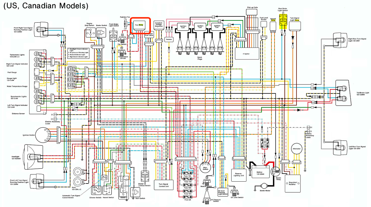

HaHa just funning yah. From memory, under RHS side cover.. by ignitor... IIRC..
Looks like this...
Looks like this...

Lol, yes I have that information and I have the actual relay in my hand but unsure where it is mounted on the bike. I've just mounted all electrical components after having the frame painted but can't seem to find a location for the relay. It must double up on an existing location?
