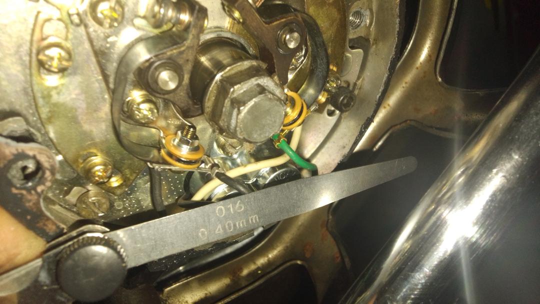

Kawboy doesn't bother me at all, in fact, it motivates me and makes me see that I should pay more attention to what I read and to the small details.
I simply remembered a figure of 0.16 and I kept it in the drawer of my brain where I keep everything related to the decimal metric system, here we don't usually measure things with the thickness of the big toe.
Regarding your observation, I read it just before going to sleep, I admit that I was awake for a long time considering whether to go down to the garage and finish the work at the risk of waking up the neighbors by speeding up or falling asleep, I opted for the second option.
Today after lunch I sacrificed my half hour nap and finished work.
Issue resolved.
