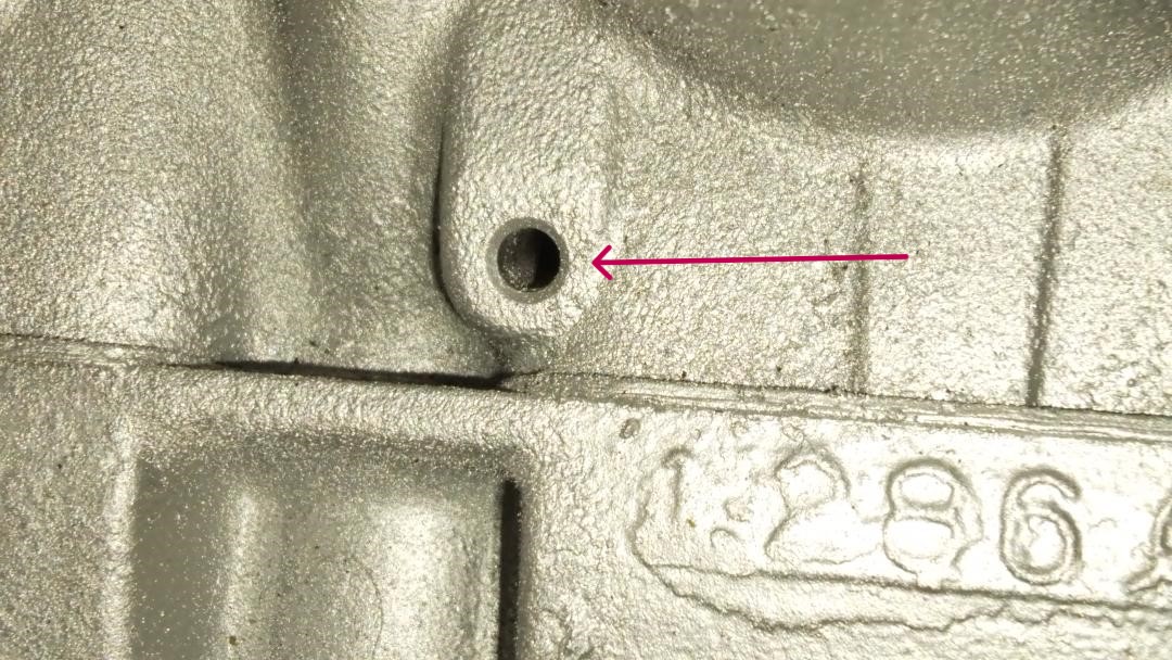

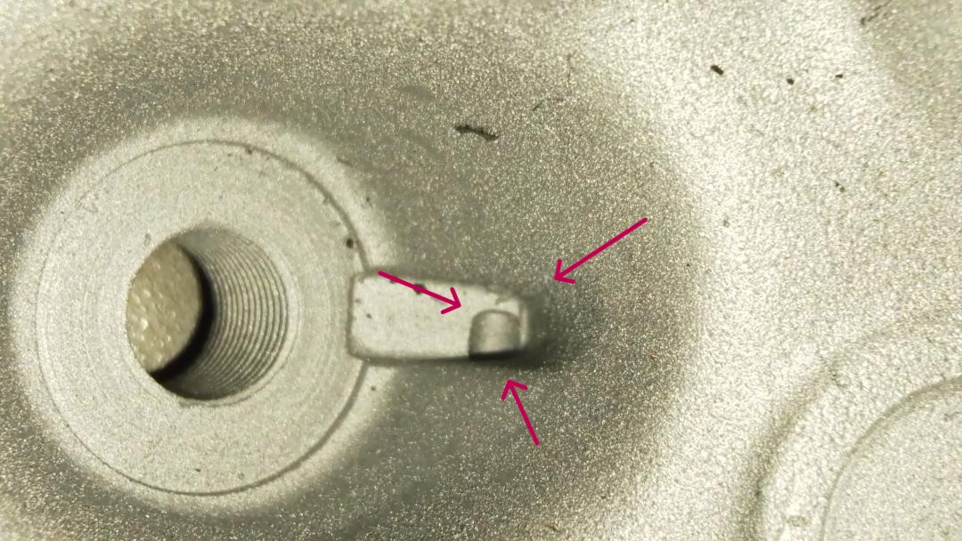

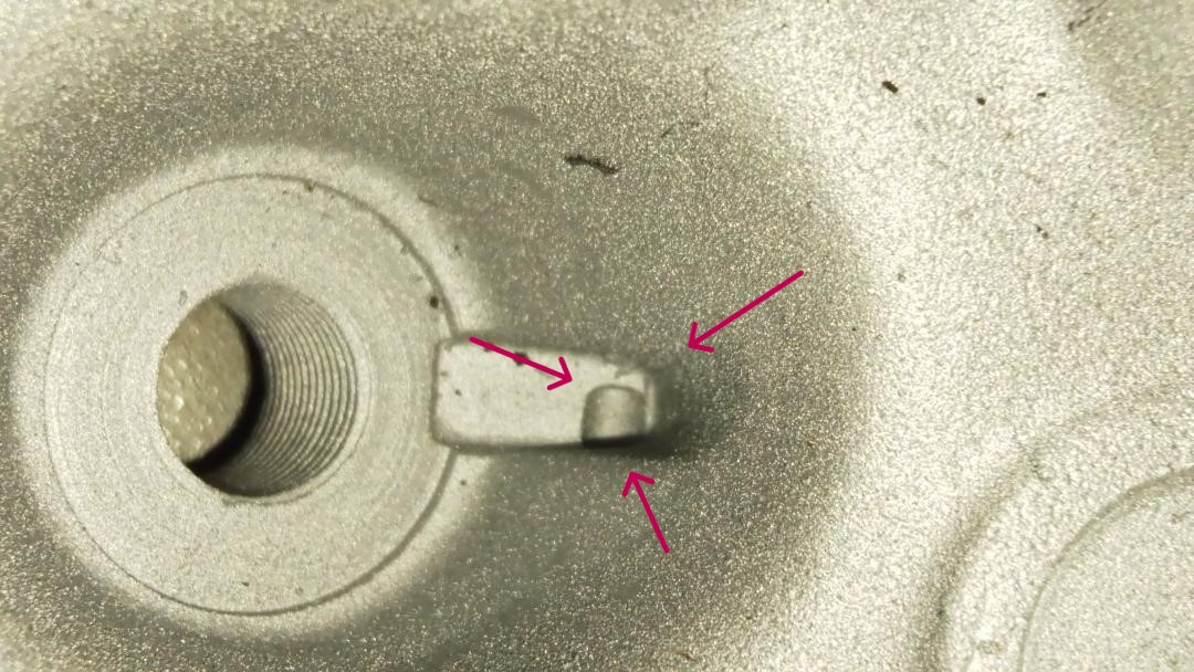

#32254
In this photo you can see the drain hole next to the spark plug thread.
They are located on cylinders 2-3-4-5.
Here you have one of the outlet holes, below the intake manifold and above the head gasket.

Thanks both, looks like you’ve called it exactly, those channels certainly don’t look clear, will see what I can do to sort them and clear the corrosion.
