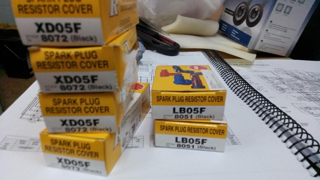

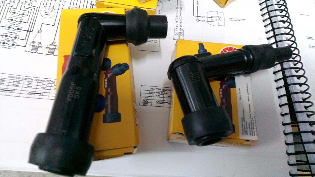

I have four units of the XD05F model mounted on my bike.
and two short right-angle units of the model LD05F.
I found these models on Amazon
www.amazon.co.uk/NGK-YB05F-black-Plug-Cover/dp/B000R952H0
www.amazon.es/NGK-XD05F-Red-Plug-Covers-C4/dp/B001KO7BQQ

Today I had time and I decided to go to the city of Barcelona, ​​to a motorcycle parts store.
The six NGK spark plug caps cost me 42 euros in total, much cheaper than on EBAY or AMAZON.
