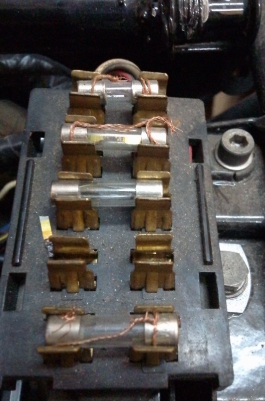

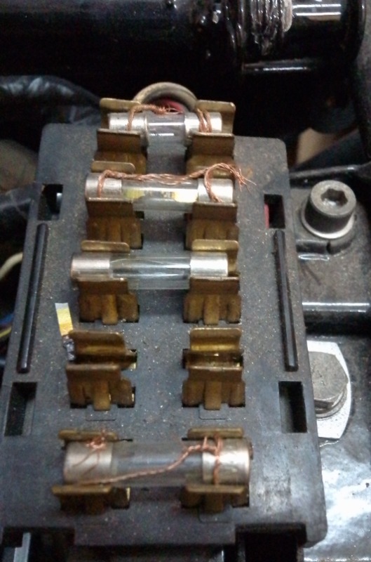

Greetings.
This is how I found the fuse box for my motorcycle when I bought it.
Can someone tell me the amperage of each fuse so I can replace them correctly?
Taking the top fuse as number one and the bottom one as number five.
Thanks in advance.
Thanks in advance.

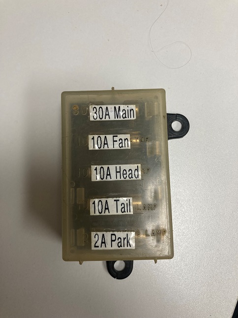

- Thanks: 951
Re: FUSE BOX
3 years 2 weeks ago - 3 years 2 weeks ago
Last edit: 3 years 2 weeks ago by scotch.
The following user(s) said Thank You: stocktoy, kawaBCN
Re: FUSE BOX
3 years 2 weeks ago
I tend to question the information provided by people on the internet and if there's a known source for the info I would trust it more. that being said, the info you're asking for is on the wiring diagram but not listed as fuses 1,2,3,4,5 but by amperage 10A, 20A, 30 A etc and to identify which fuse goes where, look at the wiring colors.
The Owners manual on page 29 states to "replace the fuse with one of the right capacity as specified in the fuse box for each circuit"
Now I'm guessing that the clear plastic cover for the fuse box has that info embossed on it and your bike is probably missing that cover

- Thanks: 951
Re: FUSE BOX
3 years 2 weeks ago
Replaced some time ago for an 8 circuit "Bladed" fuse holder, Last night I eventually found my original.<br />The cover does have the Amp ratings as Kawboy indicated. The labelling just made it easier to immediately read the required ratings.
