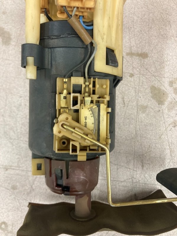

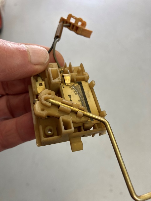

I recently had to replace the fuel pump on my '05 Hyundai Santa Fe. I had the old one on the bench for a few days and I kept looking at the fuel sender. "What are the odds?", I asked myself.
I checked the resistance at FULL and EMPTY and found the following:The relative “full” and “empty” position of the float is the same as the 1300.Empty: 121.5 ohms. The 1300 manual indicates a value of 102 – 118 ohmsFull : 4.3 ohms. The 1300 manual indicates a value of .5 – 5.5 ohms.
I've got this sending unit tucked away !

A conversion would be easy.
