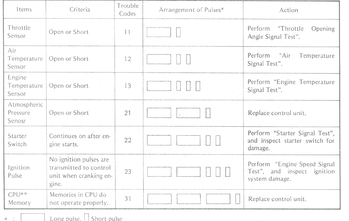

When i try to start the motor, it wont start and in particular when i try to press the starter button, i can ear a click from the solenoid and if I try again the warning light on the dashboard for the DFI start blink. Whatching the DFI module it start to blink in morse code a code error but I don't have the manual for the bike, can someone help me? It blink two long flash and then 3 fast flash than again ( - - . . . ).

As far as your DFI code as per the chart I got from the Zn1300 Manual what the DFI is telling you is that there is no pulse signal coming from the engine and of course there's not. The engine is not turning over so don't worry about that at the moment.
