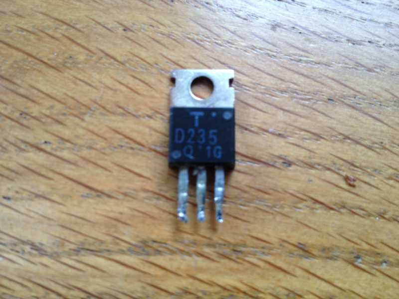

Got it all to bits and this seems to be the culprit
the number is D2350 .1G
all the other components appear to be working and the board is clean
the Zenner hasnt blown so there hasnt been a short.
cant find any info on the transistor, who made it and its values.
might go and see spotty birk at Maplins.
the closest match i can find is an NTE2317 but not sure.
Ian

This number also crosses to
d235 crosses to nte#152 price is $2.49ea My local supplier has 1 in stock price is $2.49
