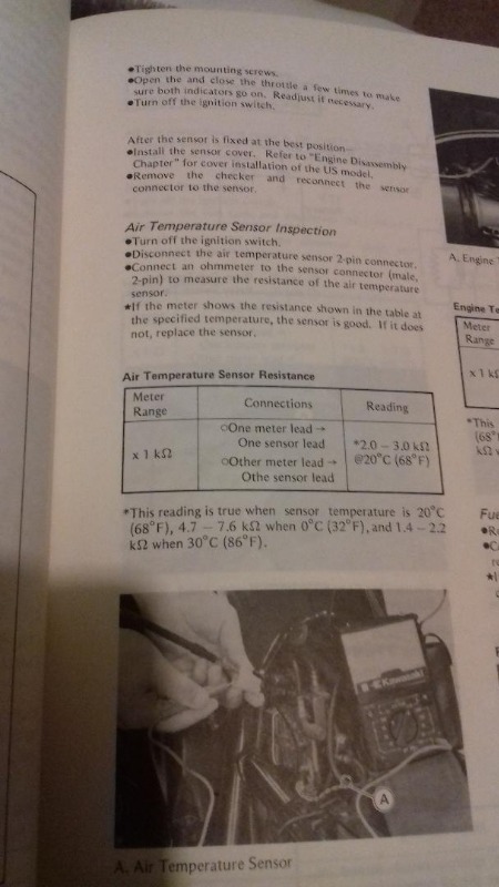

Hey all,
So a previous owner of my bike soldered in a resistor to replace the air temp sensor. I cant find the sensor test in the manual. Does anyone know what the resistence range should be? Or can post a pic of their manual with the test?
Thanks,
Isaac
Thanks,
Isaac

Re: Air temperature signal test. 1985 zn1300
7 years 1 month ago
- Rage10
- Posts: 50
- Thanks: 3
7 years 1 month ago
Yep that's exactly what I need. Thanks!
