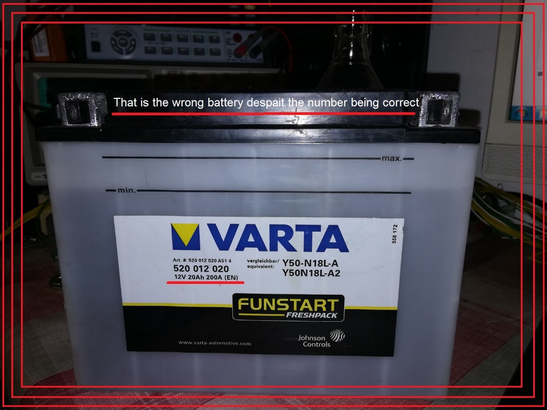

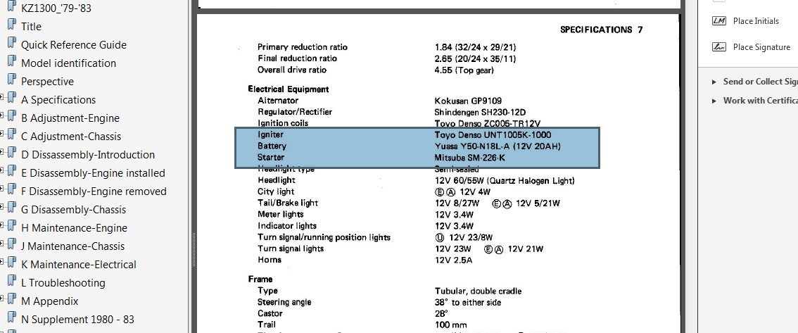

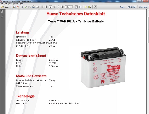

Hi i had this kind if a problem before, where cold engine start was not a problem but when hot the starter could barely turn the engine over. Have you rebuild the starter it self already? Also I have seen on my bike the ground cable being rotten inside, and contact area to the engine is very small. Also there is the starter relay which could be bad, if you measure voltage across that, the problem could be there.
However you should first measure the voltage drop across the poles of the battery with good multi meter (be careful because if sampling rate of the instrument in slow it will not show you proper results as it averages the value only, that's very important). You kawa's battery must be able to output at least 230-240 ampere of current, and it is written somewhere on it and if its less than that could be the issue. 200 amp is not enough and it was the issue i had.

Rep manual where you see the Y50N number
Thats the weak battery from Varta despeit the Y50N number being the same as in the manual it can only output 200A
And now the 240 Amp Yusa battery.
All in all start with simple stuff first in my opinion its the battery but measure again like i said.
