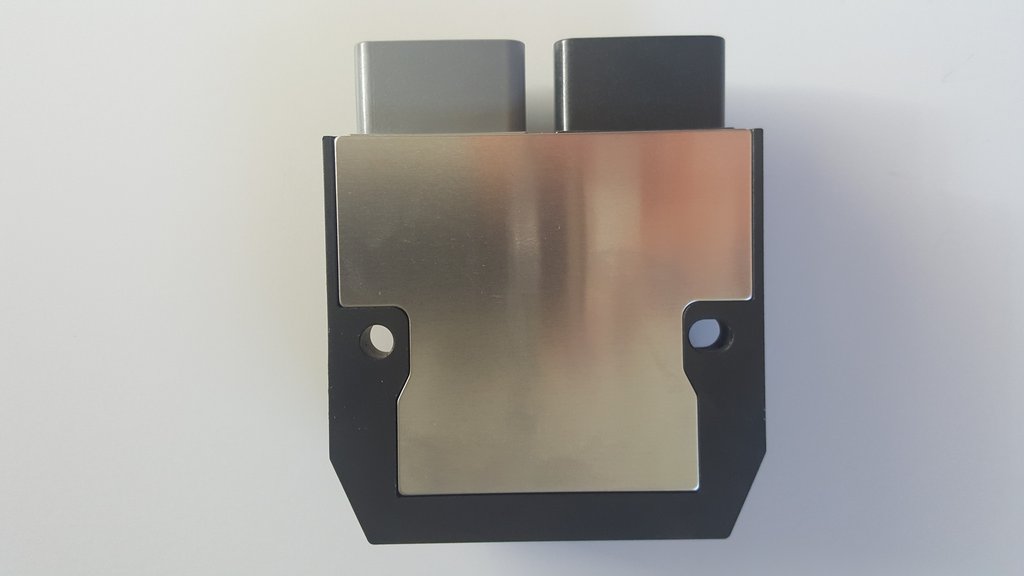

From the motoelectrix sight:

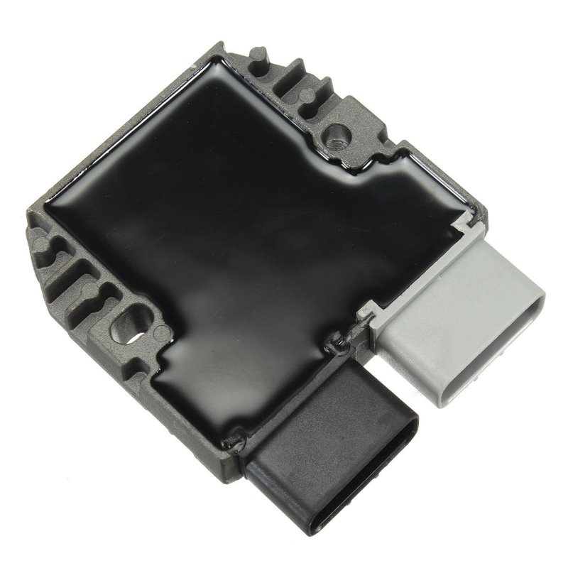

Beware of the copies out there now being sold they are substandard quality made in China I sell genuine Shindengen quality only. Note: the copies do not have a metal back they have black potting material only. Such as on eBay; "For SHINDENGEN FH020AA Regulator Rectifier Upgrade Kit Replaces FH020AA"
Apparently this is a cheap copy:
Compare with: motoelectrix.com/ and note the hardware too !

I bought a used one from a BMW in a breakers yard as they were fitted as standard to that model.
As I remember there are several tell tale signs that differentiate the fakes. Number of fins and the points where there is a recess in each of the fins differs. I think the fraudsters might be in fear of a 100% knock-off so have subtle differences.
Google will show you how to spot the fakes - but you do need a very keen eye!
By the way - I did by a brand new Chinese fake by mistake that claimed to be genuine. It was charging at 17 volts! Be very careful
