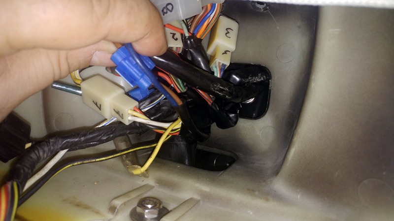

I got this photo from someone when asking a similar question, and I bet he wouldn't mind me re-posting it. I am still battling the same exact thing! The place is very cramped and confusing. In general, I don't understand why the wiring has to always be like a bunch of seaweed pulled from a beach!

Based on the info I already gathered, here are two photos of my current state of headlight affairs.
The main harness comes up from below between the horns. It enters the headlight bucket through the bottom hole, the wires from the ignition and all the others coming out of the speedo unit, enter through the top hole. They are connected inside, then comes the 'nest' forming... The bottom nut is the one connecting the bucket to the headlight bracket underneath (had to buy it as well).
My bike came with no lights at all - headlight, tail, signals etc., so all is new to me as well. I still need to figure out how to connect the front turn signals. I don't see any wire bundle pointing to them from the harness - I might have missed something and need to investigate it more.

Perfect pic's again, you're spoiling me!
I'm in the workshop tomorrow so I'll ID the indicator wire colours and where the route from, hopefully then you can trace back and see if they're there or been cut back etc.
Your 2nd pic suggests my back-shell isn't the Z13 one, mine has massive cut-outs for the loom, literally about 40% of the back of it, and they look original moulded edges etc.) so it's maybe a GPZ one.

Stan's photo depicts mine as well. (80 KZ 1300) I agree that it can look like a "dogs breakfast" inside the bucket but a sensible arrangement of the wires and plugs does give ample room for the back of the headlight and the bulb connector for it. I also have a "sizeable Loop of the main-wiring loom, before it enters the bucket. Consider it to be "strain-relief". Don't expect to get the inside of the bucket arranged correctly the first time. I've spent a lot of time over the years re-positioning "this connector and that connector" in order to keep the wiring volume, compact. I have several of the smaller plugs attached to the inside of the bucket with two sided "foam" tape simply to achieves some order to the wires. This only works if, when positioned, there is no "strain" on the wires of these plugs. Otherwise the heat from the headlight will release the tape.
Simply put: Just make the effort to make it look like a nice "nest" which surrounds the back of the head-light and it's connector.
