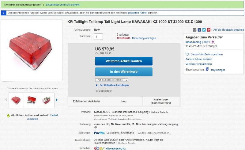

I just need an opinion. Will it fit?
KR Taillight Taillamp Tail Light Lamp KAWASAKI KZ 1000 ST Z1000 KZ Z 1300

I Googled that part # quoted in the ad and it shows up as a Emco Taillight and it doesn't look anything like the one pictured. Maybe send the seller an inquiry and get them to confirm the dimensions. All I can say is something is funny with the ad.

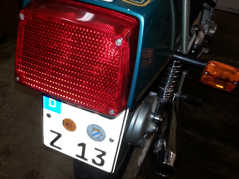

No it want fit KZ1300, it's a lot smaller, if i remember correctly the difference is about 1,5 cm in with. I bought one of them from klasa-racing in E bay sometime back (Manufacturer Part Number: 62-21522). If You count the dots on the bottom of the lamp, the one from eBay, they are 23 and in the original lamp are 29 with the space between them being the same. Also inside of the light is different, then the original, probably not the big issue but still. The screws are in different places as it is seen on the pictures. Hope it helps. On the picture here my 79' Kawa with original light. (Picture from eBay is for reference only, and if necessary ill remove it).
