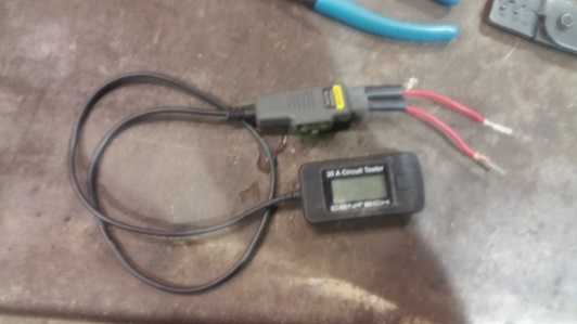

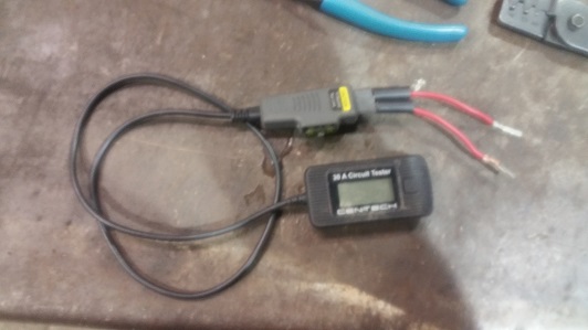

take 4 lets see if they load now
yea me, I guess windows 10 image formats changed a bit loads alright from w7.
Anyway hook this across blown fuse holder, power up circuit to be tested and should show load.
