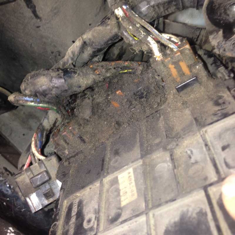

hi all, after cleaning every junction i could get to i finally got the volt drop down to .3v.here is a pic of the back of the fuse/relay box.
i think this was the biggest part of the problem. thx pat

U-G=L-Y !!!!! How in God's name did that get so filthy? It's all tucked up under the seat. It's not seat foam particles is it?
