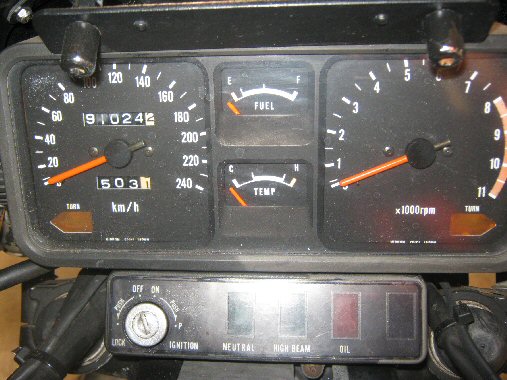

The European (UK) speedo for the Z13 goes up to 160mph. I replaced the 85mph one on my KZ1300 with one I found on ebay. You can remove the mileometer mechanism so everything stays the same.

I had a thread about this a while ago too
. After hours of looking at speedos I settled on a pair of needles from a buddy's bike. His was a CX500. Same needles exactly except that they are white with red tip.
Really most needles will fit and I calibrated mine by moving the old needle to a certain mph like 10, holding the bell at the bottom still to keep it there, removing the old one, then pushing the new one back in at the same mph reading. Probably not the best way to do it but the logic seemed sound to me
I only used the needles from that cx out of necessity because that was what I had available to me and it was free since his gauges had grenaded themselves inside.
You could salvage similar needles from any junk bike or junk speedo for a reasonable price though. I found that Nighthawk speedos have close to the same color and other Honda speedos are pretty close as well if you're looking for an original look or want to get close. A bike junkyard would be handy for this
Here's an ebay item # of a nighthawk speedo for reference: 161155753682
The German needle replacements are a great option too. They function and look great
Hope this helps!

Does anybody have more info on the german with needles and faces like how to get hold of them or a link to a website
Re: SPEEDO & REV COUNTER
12 years 1 month ago
Hi Slide, all
I suppose those are the ones sold by Wilfried (der6Zylinder@web.de). If I recall right he has more than one type of needle.
regards,
regards,
- Posts: 594
12 years 1 month agoslidewayes wrote: Does anybody have more info on the german with needles and faces like how to get hold of them or a link to a website
German site :- www.z1300.de/index.html
and click on the "Meters" link to see the needles and meter faces, you can e-mail him at mcg@z1300.de he speaks and replies in English and is very helpful
