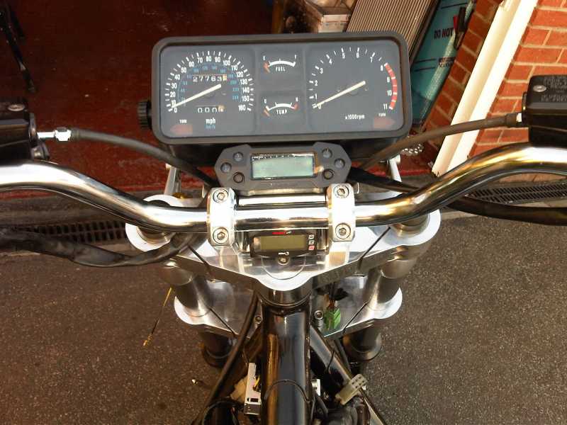

Does anyone know where to get replacement cluster needles. What about backing plate for speedo and rev counter. Would be good if someone could produce these. Any tips on removing the speedo and rev counter needles.

I got new needles from the german shop, he sent instructions with the needles, he said to mark the tacho "drum" when the needle is pointing at 4 or 5 with a felt pen, the mark should be on the drum and the cross piece so you can line them up later, or tape it in that position with masking tape or the like, but still mark it incase it moves, pop the old needle off using two teaspoons, sounds weird but they get right under and you can apply equal pressure, get the new needle and press it onto the shaft making sure the marks are lined up and the needle points at the reference point you have, this gives you the correct loading with the return spring, do the same with the speedo using a make at about the same angle as the tacho, easy and works well, so long as the originals are on and you can tell where the needle was. The german shop also has replacement backing plates.

I bought new ones from MCG in Germany. Had a bit of trouble getting them in sync though. What I did with the tacho was to run the engine to normal temp then mark where the needle was. Then stopped the engine, removed the old needle then started it back up - meant I could play around with the position of the new needle while the bike was running.
The speedo was just trial end error !!
