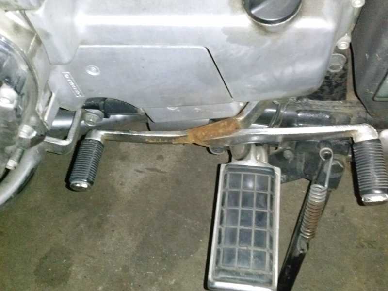

Did I show you guys this?
I bought a shifter for a Voyager cut it flipped it and
welded it to make a heal toe shifter
works great
Thanks Guys
