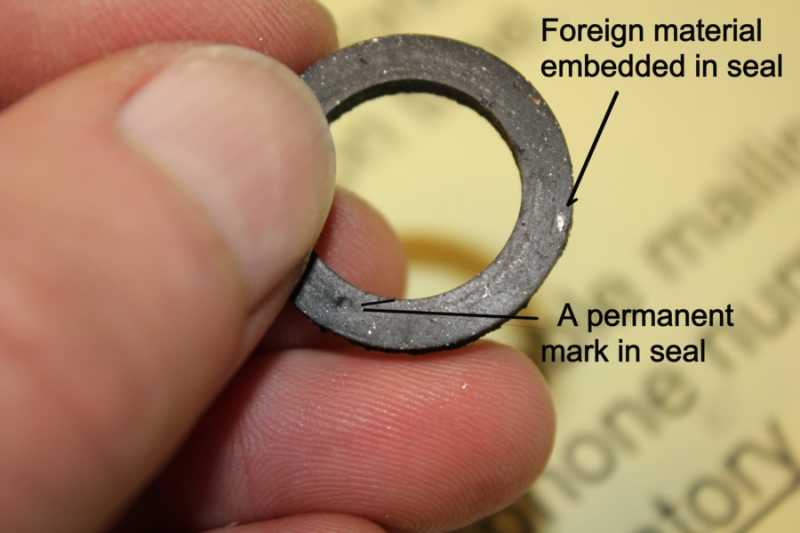

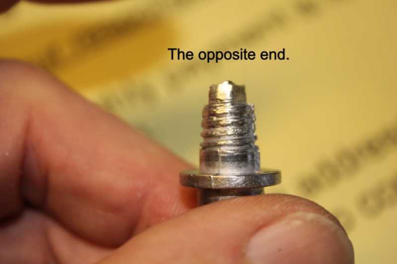

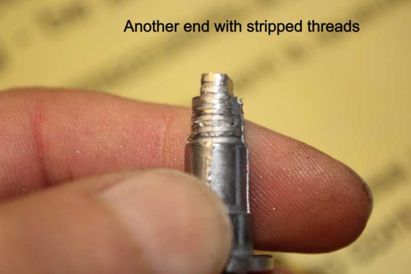

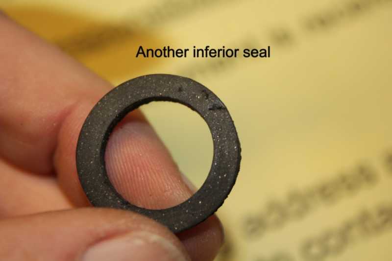

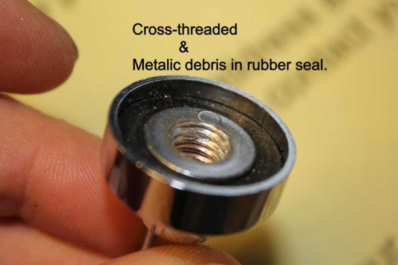

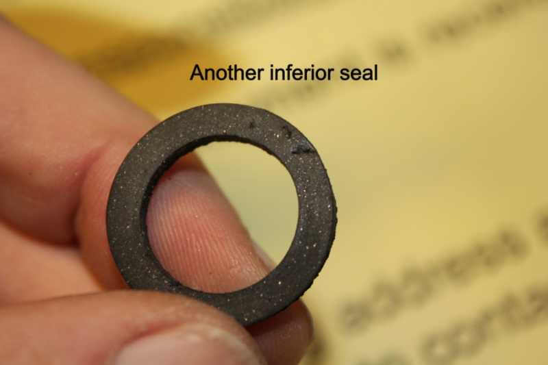

Here are the pictures I sent to the seller at his request, presumably to validate a refund.
My time is worth more then the cost but: IT's THE PRINCIPLE !
Cheers !

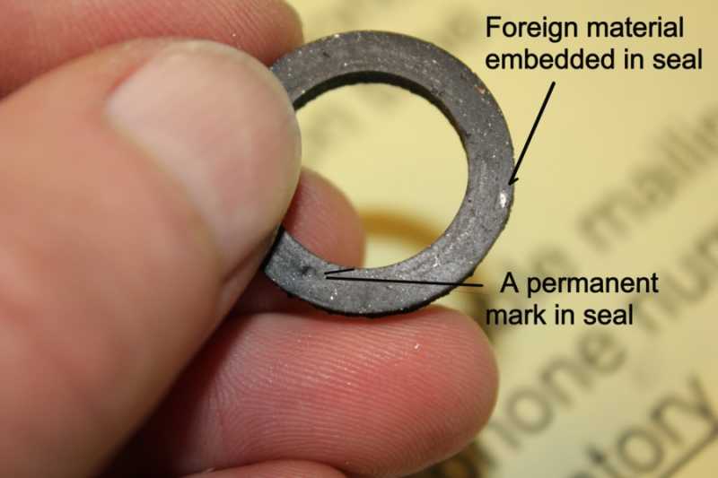

Cheers !

Scotch, excellent pix! And, it does this old geezer good to hear somebody else say "IT's THE PRINCIPLE!" Those chinese will just keep pouring more crap into this country until people will take a stand.
Those parts are made from "white-metal", or, as we used to call it in my younger years, "pot-metal". When they smelt the raw materials for aluminum, there is left a foamy crud floating on top. This is still good stuff, but for purely decorative purposes, and to form it into anything requires lots of pressure. They used to use it to make the hood ornaments in the old days. Smack it with a hammer and it will just crumble. Too bad those chinese are still misusing it to make parts that merely give the appearance of function!
To find similar filters check out any aircraft surplus suppliers in your area. They are used to filter hydraulic fluids and hence, are made to withstand higher pressures, too. That fancy one with the aluminum wrapper is what they will look like. Also try any of the speed equipment suppliers like Jeg's or Speedway Motors. You'll pay more, but you'll also get more.
Chinese manufacturing has come a long way in the last couple of decades, but some of them keep using the old, cheap methods and materials.
I hope you do get the refund, but even so, thanks for taking the chance and actually, effectively, protecting the rest of us by sharing the results!

Ever hear the "story" about the glass filter, cold gas and hot motor, rough ride, broke glass, bike burns ??, couple of guys have told me the tale when I mentioned the glass filter, maybe the "Effluent" didn't stop enough fuel flow and it hit the fan??
