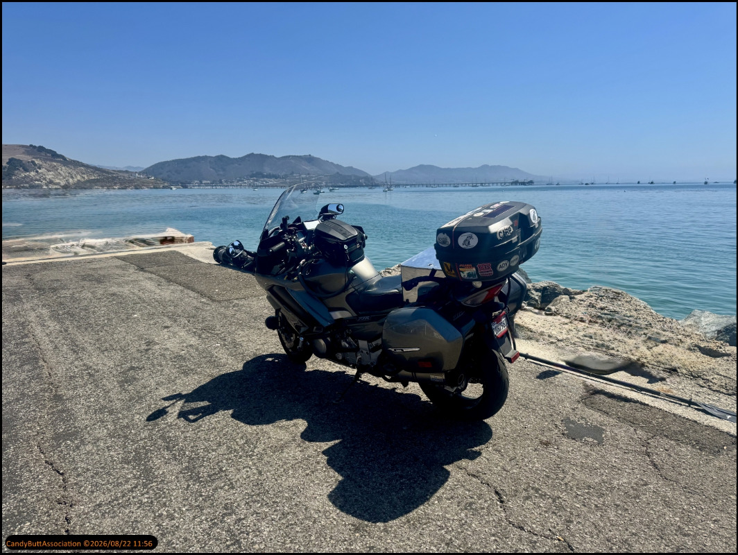

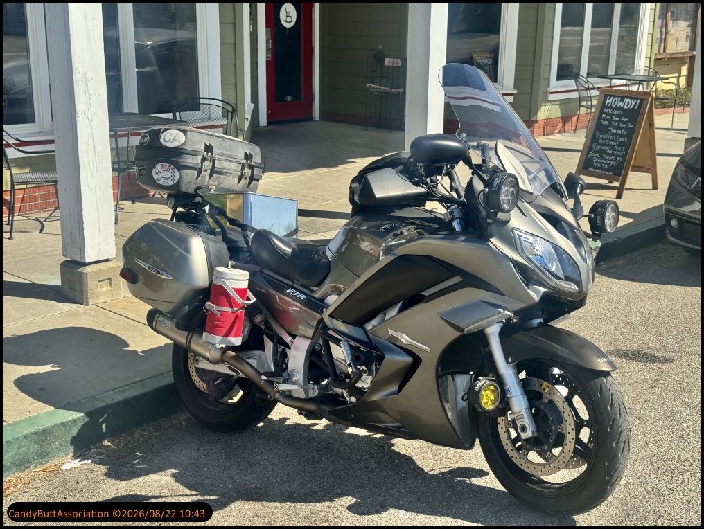

My best Long Distance Rally Bike. 2013 Yamaha FJR 1300. Aux tank at 2.1 gallons + 6.1 gallon main = 340+ per fill up. Penske 5-way rear shock, Gran Prix Suspension cartridges in forks. Russel Day Long saddle. Handlebars raised and rear set. 1 gallon of on-board ice water via hose for drinking on the ride. Ring mounted tank bag for fast on-off at stops and provides snack storage. ClearWater LED aux lights. OEM headlights with 'defeat' switch to save wattage when running heated gear, aux lights, aux fuel tank fuel pump.
Her name is Naomi. She's a BEAST.

I know its the postion of the bike in the second image however it looks like you have a Gatling gun coming out the front of the bike (hopefully only for defensive driving purposes) lol

Full on .50 automatic caliber left and right side. Ammo string fed from fake saddle bags. Gel based nitro glycerine in the fake aux fuel tank with rear mounted flame thrower.
GPS fed gyroscopic AMD controller to ensure the bike remains straight and even when firing only one of the .50's.
You can call me Bond, Don Bond!
