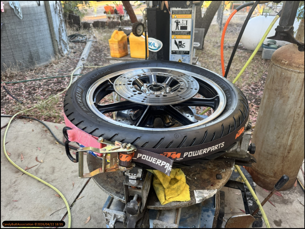

I cannot get this speed to seat on the rim.
I've used lube, WD-40 put a strap around it pressurized it to 110 psi in the second bead will not settle in.

wipe the tire down with dish soap and give that a try.

I've had good luck with heat. Release the air. Crush the bead where it is set. Put that tire in the HOT California sun, both sides, and try again.

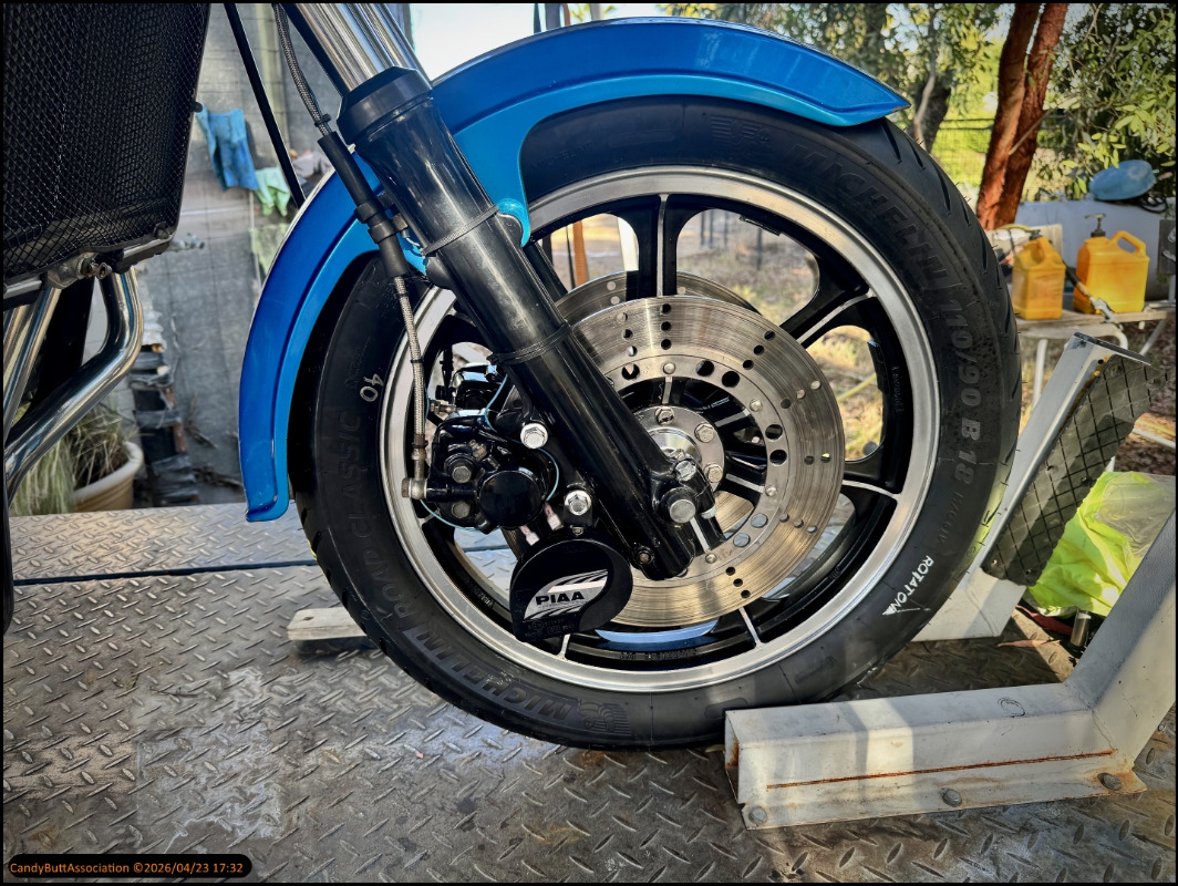

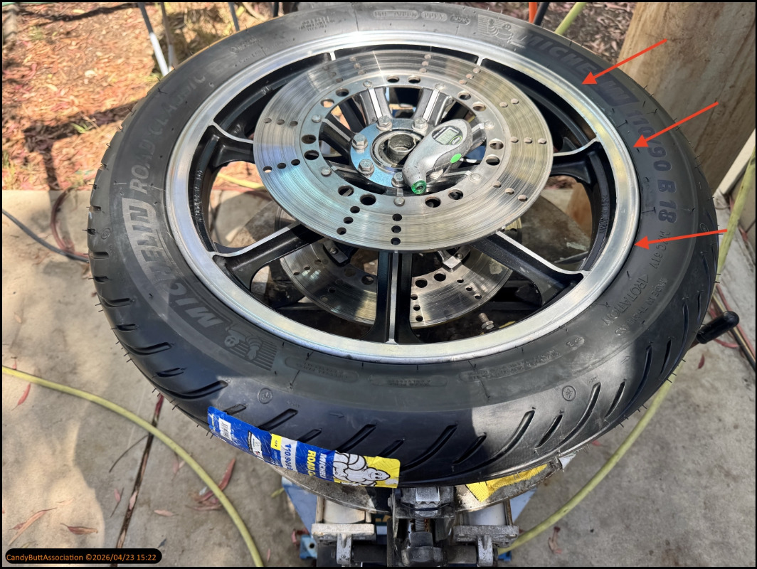

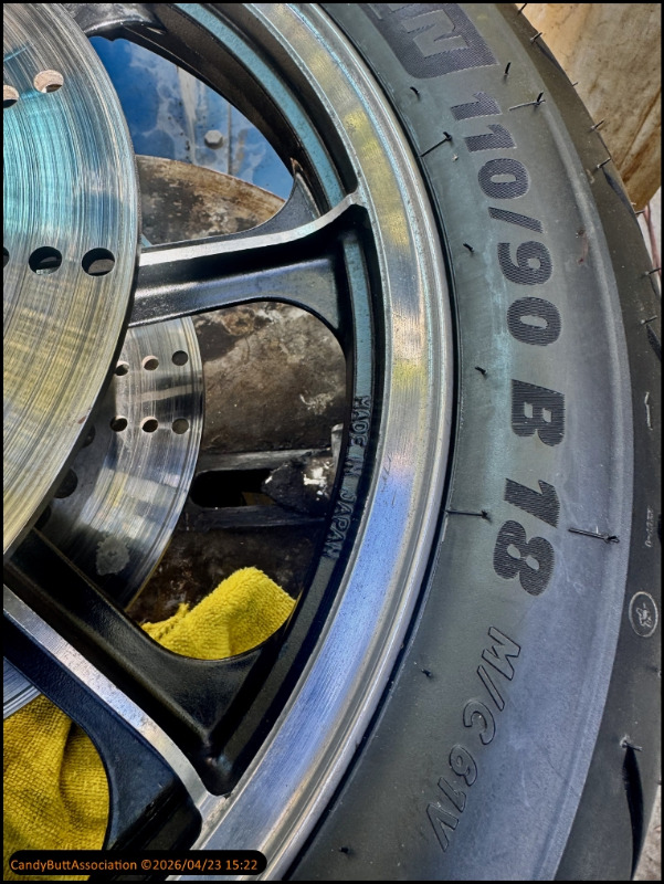

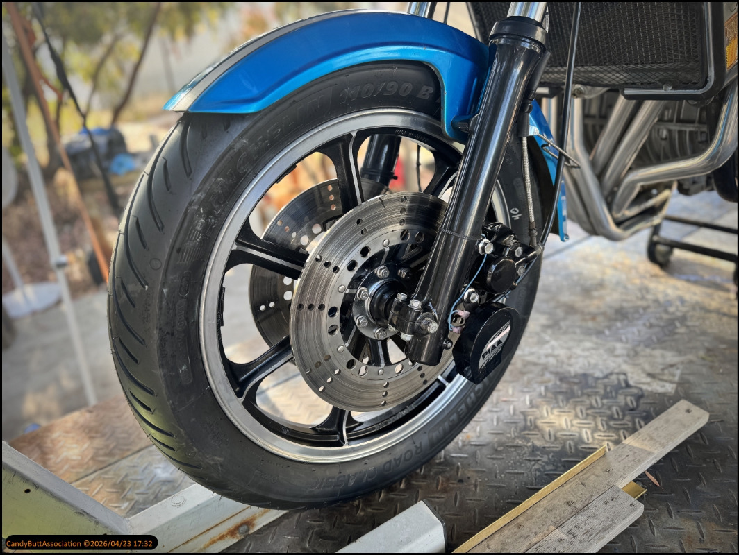

2026-04-23 Front Tire Seated!
After sitting over night and all day today in the sunshine... The strap and tire decided to play nice..

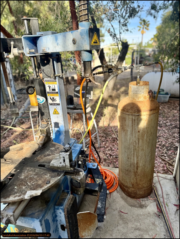

Cranked the compressor to full tilt, ~130 psig.
Filled the accumulator tank to 130 psig.
Isolated the accumulator tank, drained the compressor to hit low level turn on, pressurize to ~130 psig.
Lubed the area again with Ru-Glyde to help trap air inside tire.
Hit it with a blast from the past, Memorex style.
Oingo-Boingo she's a done deal!

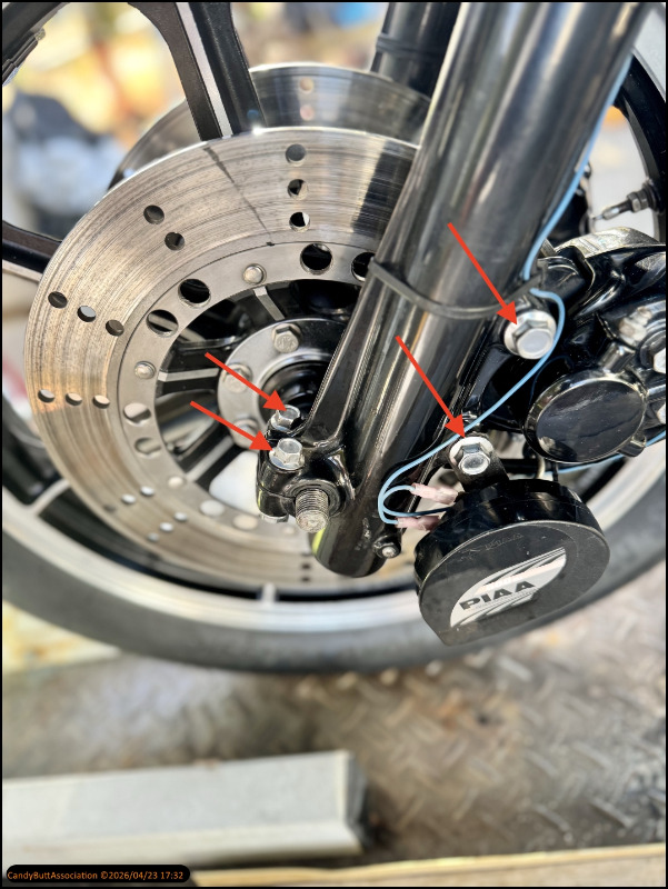

While apart, yes, I did polish the axle, used a Dremel with soft metal attachment to clean up surface rust and road gunk.
And...yes, I did wax them.
Don't worry about the axle nut missing. It's not all THAT important.
Ok, it's drying after being painted.
After 47 years it was pretty grody.
I need to find a quality supplier of metric SS bolts or chrome.
Beltron maybe?

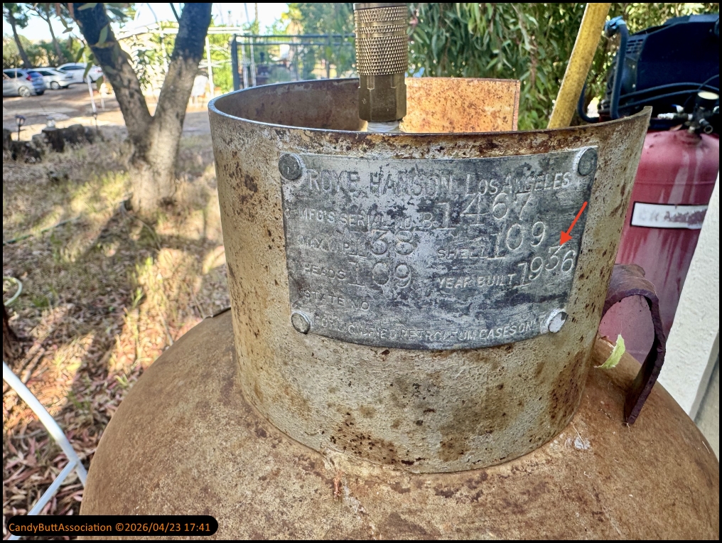

Here's my accumulator tank.
It's a young pup as you will soon see.
It's 90 years old!

90 year old propane tank for a reservoir?? Not in a million years. I wouldn't trust a 10 year old tank. It's one thing if it explodes when filled with water pressure. No harm no foul. It's a bomb waiting to go off when pressurized with a gas. Ditch the Bitch and spent $50 bucks and get a new one. You don't need a 100 LB tank for a reservoir unless you're taking lug nuts off an 18 wheeler with a 1" impact. Life's too short to be tempting fate.
Last edit: 6 months 2 weeks ago by Kawboy.

Hi glad you got your tyre sorted i'v luckily never had that problem i have all ways takin out the valve so the air gets in quicker and use a lube as well
