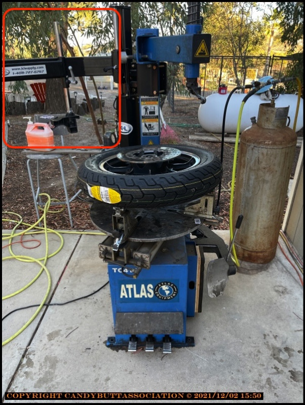

Bill... Agree. The Atlas changer I have has an additional 'foot' to keep the bead opposite the duck head centered... which allows easier install.. It's a brilliant piece of engineering and makes all the difference in the world.
I'm still learning how to properly use the changer. My guess is when all these tires are installed, I'll have it mastered.
...and I started off on rims that aren't pristine, just in case...
...and I off to do more tires!
