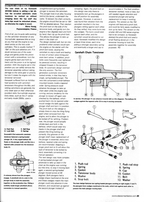

gd4now, one of the members over at KZR, posted this about cam chain tensioners. I think it's good and historical information:
Thanks

If / when I begin restoration of my 1300, I intend retaining the stock tensioner, but with a pinch bolt arrangement to stop the push rod backing off.

Kawboy recently expressed an opinion in support of the OEM tensioners. Frankly such an opinion ran so directly against what has become (at least in my mind) the accepted conventional wisdom that I had to take a closer look. Are these failures a real issue or has the internet just created another meme? I've done a bunch of digging even inquiring at other Kawasaki sites (you may have noticed).
We don't have enough information yet. Truly, the poll will give the best perspective, if we can get 20 or so answers. It may be that perception is the truest view of the issue.
At the very least Kawboy and I will be revising David's FAQ with some real world data as context.
