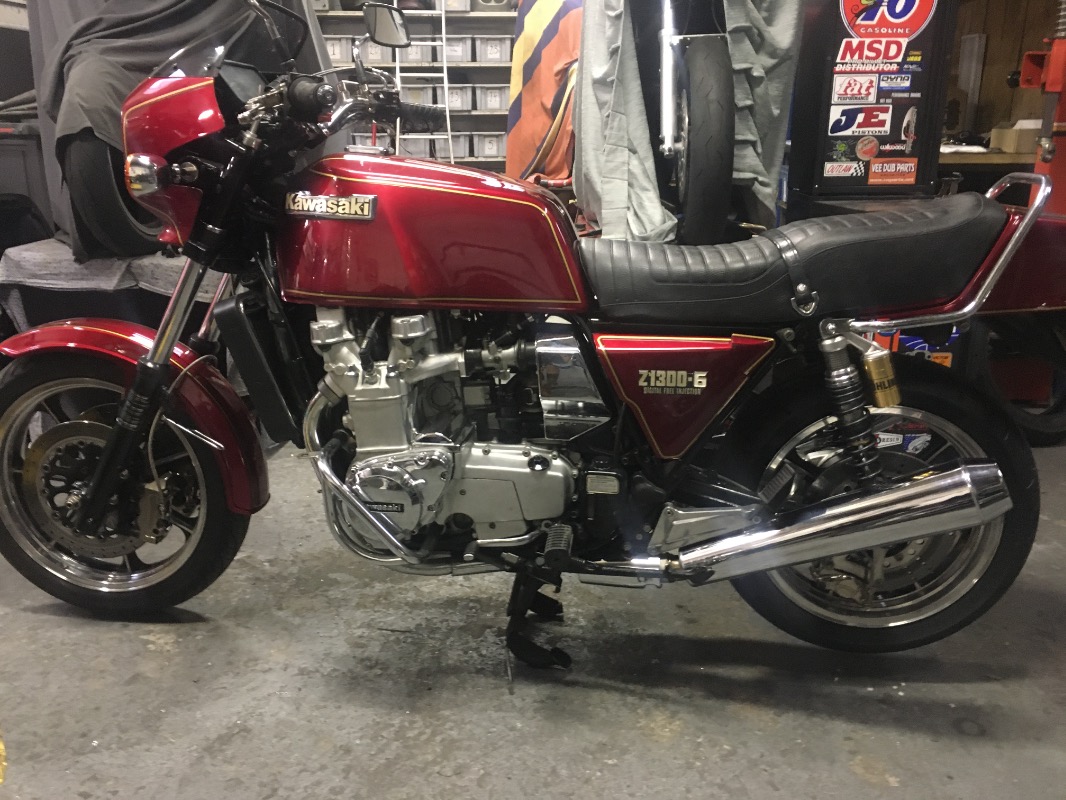

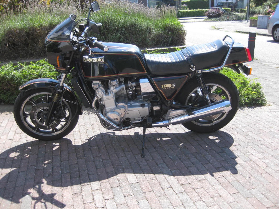

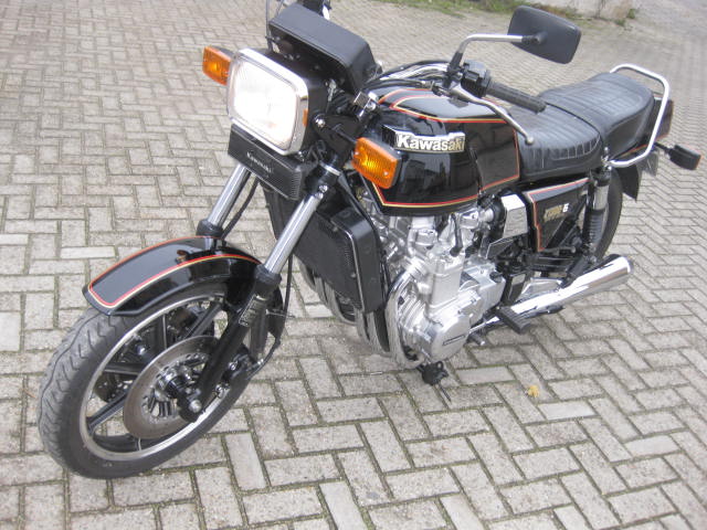

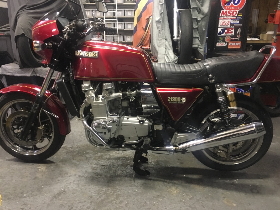

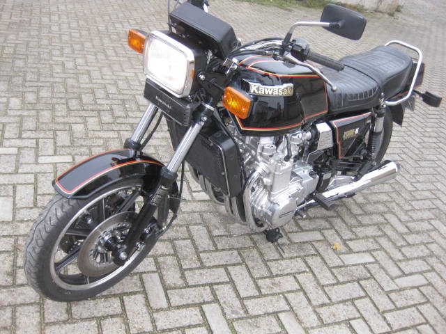

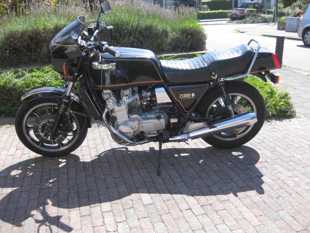

Hi, I am a bit late with my response but after owning two black ZG1300's ( called Z1300 DFI overhere), one from France and one from Switzerland, I bought another red 1984 A1 Z1300 DFI from France. Are you still after info from these bikes?
Here are some pictures:

Lovely collection of bikes you have there. Of all the models, these bikes you have are probably the most desirable and most collectable. Lucky you.
