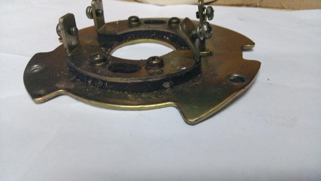

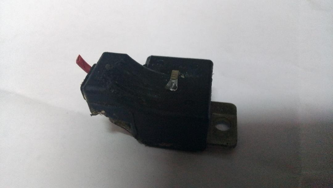

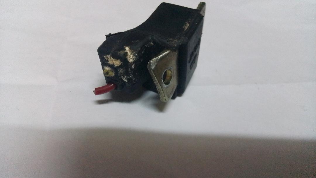

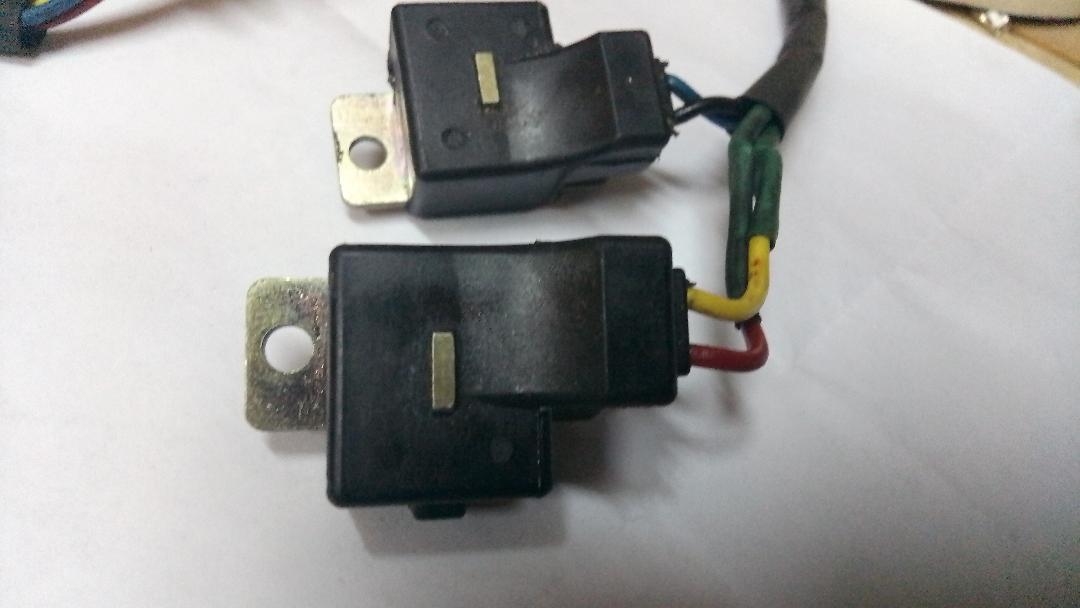

When I had the accident I wrecked the pickup coils.I had to replace the entire engine block housing and the timing advance mechanism.
I have mounted on the bike the used pikup coils set that I got from Australia mounted in its housing, I decide to change it for a spare one that I had saved from when I bought the GPZ1100 project.
Once the set of pickup coils is mounted, I start the bike and two cylinders fail again, there is a pad that does nothing.I remembered then one of the initial failures I had with Christine, 20 minutes after starting the engine also lost two cylinders, the cause was one of the pickup coils that when it warmed up stopped working.The same thing happens to me with the ELR, it works just long enough to show the bike to sell it, then it stops. I ordered a complete set of pickup coils and chuck, reference 59026-1133.The cost is 190 euros and the order will arrive directly from Japan in a couple of weeks.
