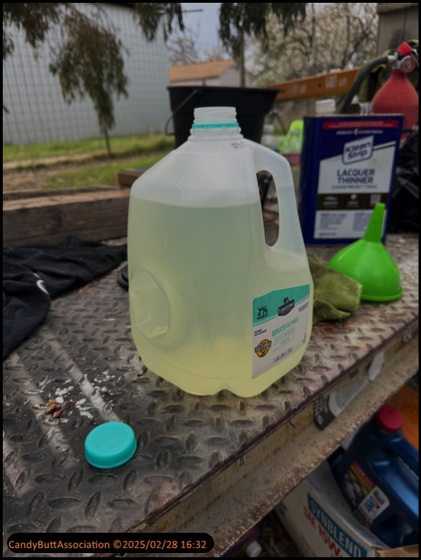

Reserve Fuel, Pingle petcock.
Slightly less than 1 gallon.. might be some left in the tank.. tried 'sloshing' best as possible on center stand..
Just FYI, another data point.
