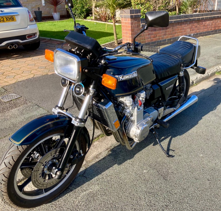

Out on the beast today, bit of a false start as she only fired up on four cylinders After much cursing and swearing and as I couldn’t think of anything else I tapped the float bowl on the offending carb and all was good. Did 60 miles and apart from being a bit “fluffy” when pulling away and the idle being a bit lumpy she ran really strong. I’m hoping balancing the carbs again will cure that. Really enjoyed the run out despite the bloody cold.
