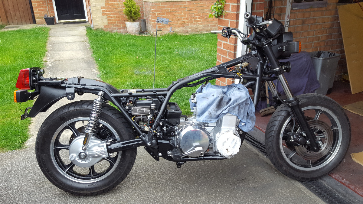

Im in the process of fitting the wiring loom on my 1982 A4, I got it from a friend and it was partially stripped down, I have rebuilt everything and I am just having a few problems routing the wiring. I have got everything working, but I am having a bit of trouble behind the right hand side panel with routing, I cant find any good pictures anywhere that show the way the loom comeback from the engine and found when I went to fit the air box all of the wiring was snagging as there is not a lot of room and there is quite a lot of connectors and wires in the area. , I would be grateful for some pictures or someone pointing me to a previous instruction. there are very few pictures without the side panel and I cant find any with the air box removed to even show if the wiring goes behind or in front of the frame.

Heres a pic of mine as I was rebuilding it and has refitted the harness.
Hopefully its some help and you can save photo and zoom in on it as required ?

Thanks that's a big help , the problem is I had all the wires and plugs connected and I couldn't get the air box in I will have a look at tidying it up , it is always better after a nights sleep I was still at it at midnight last night.
